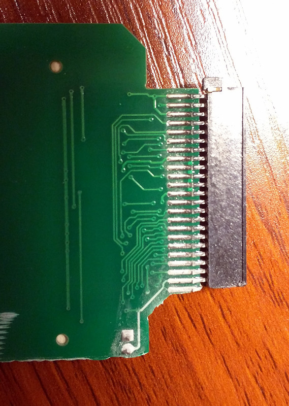

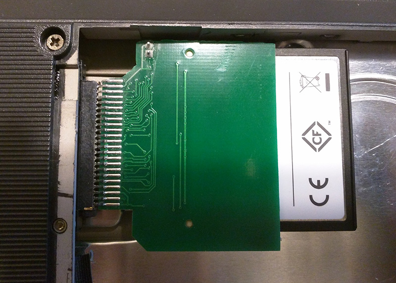

For anyone who has a Thinkpad 240 without the hard drive connecter, you can modify a 1.8" IDE to compact flash adapter and use a CF card with "fixed disk mode" for a poor man's SSD. Just cut off (carefully!) the three pairs of female pin holes to the left of the marked "pin 1". Remove any loose metal pin material. Next, snip/cut off the plastic guide on the right of the adapter. Now carefully trim and round both ends and trim the ridges on the top and bottom of the connecter. Finally, trim the left side of the "board" flush with the compact flash guide arm. Insert your "fixed disk mode" CF card in the adapter, turn the adapter "upside down" (CF label facing down) and, with good lighting, line up the Thinkpad's pins with the adapter's holes and insert. If it doesn't slide right in, carefully do a little more trimming. Secure the back end with some good quality electrical or duct tape.
I have done two of these so far and both TP's have been running great for three weeks with Windows 2000 + SP4. Boot time is a little slow at about 1.5 minutes, but I haven't tweaked anything yet. "Industrial" compact flash card specs indicate much better potential life than the regular ones and 4GB Stec cards, while a bit slow and small, run $15 to $20. I will try to get some pictures ready next week if anybody is interested.

I will charge up the digital camera tonight and do a quick set of pictures from start to finish tomorrow.
The best/least expensive option will be to buy the adapter from one of the international sellers (Hong Kong) taking 6 to 10 business days for shipping. Type in the ebay search box: "1.8 ide" adapter.
So far I have just used the "green and white" ones, but the black and white models will probably work also.
Re: Thinkpad 240 Hard Drive Connecter for CF <$10 + 15 min mod
Bill says we don't host pics on this site. If any one would like to see a quick set of photos ( 6 ) email me at randellbutler@yahoo.com
wolfrb sent me the photos and I've posted them on his behalf here:
http://thinkpads.kiff.ca/images/rbutler ... 1-crop.JPG
http://thinkpads.kiff.ca/images/rbutler/CIMG4442.JPG
http://thinkpads.kiff.ca/images/rbutler/CIMG4448.JPG
http://thinkpads.kiff.ca/images/rbutler/CIMG4449.JPG
http://thinkpads.kiff.ca/images/rbutler/CIMG4451.JPG
http://thinkpads.kiff.ca/images/rbutler/CIMG4453.JPG
I will probably leave these up permanently unless wolfrb requests they be removed.

A huge thank you for both wolfrb (for taking the pictures) and pkiff (for posting them). I've ordered one of the adaptors via a polish auction site (but the price that I paid for it is pure overkill). I hope that it's going to work.
