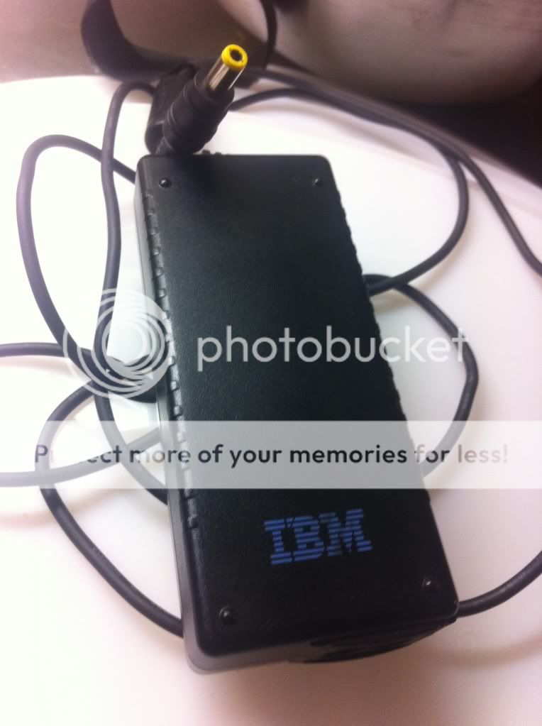

Re: Looking to buy a IBM ThinkPad 700T
Do you have a part number? I have an old unknown IBM adapter that was labelled IBM 700 series. But I don't have anything that old so I don't know which computer its for.
Is it 4 prong plug end? If it is, its for the 700-700C
IBM: 700C,701C,760XD,770Z,600X,560X,560Z,570,310ED,380Z,390X, i1200,i1400,240,A22m,A22e,A30,G40, R31,R40,R50,R60,R61,T20,T23,T30,T40,T60,T61,X21,X30,X41,X41T,X60,X60T,Z60m, Z60T, X3200 Server, NetVista M41 6792,M41 6790,X40 Aptiva 2170,ThinkCentre S50,S50 Ultra,A50p,M50,M51,M82 WorkPad 20X,Z50
No, its the round plug type. But it looks older than my T42 charger. I'll snap a shot of it tomorrow.ThinkPad560X wrote:Is it 4 prong plug end? If it is, its for the 700-700C
I have that AC Adapter. Its 2M04T7200DR, I think this AC Adapter was for the ThinkPad 600. The pin inside the 700T is bigger in diameter then the ThinkPads like T/R/X/600. There AC Adapters will not fit because the hole is too small for the 700T pin. I'll try to take a picture of the 700T next to a standard ThinkPad.
The adapter you need is the same as the 730T and Thinkpad 350 series.
http://www.ebay.com/itm/730T-ThinkPad-A ... 3ccff82ff3
The adapters from older 15v Toshibas work, too.
