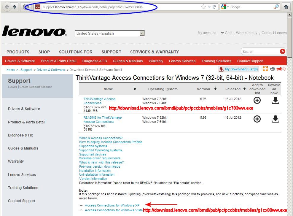

by rkawakami
@JDH
From my vantage point here in California, the site that Bill B. provided does lead to the Windows 7 version 5.95 of TVAC. Here's a screenshot:
http://www.kawakami-ca.com/images/TVAC_5.95.jpg
Re: Access Connections V5.93
Posted: Sat Aug 04, 2012 7:24 pm
by killer
Following on from Ray's post, I went to Lenovo Support UK. Access Connections V5.95 was available for download. Downloaded, installed, and now working.

So 24 hours later, the link Bill B. posted leads to V5.95 as it should. It did not do so yesterday (I double checked before posting). So it must have been working its way through the system (not one of Lenovo's strengths). I have downloaded it and will install it within the hour. Thanks, .... JDH
