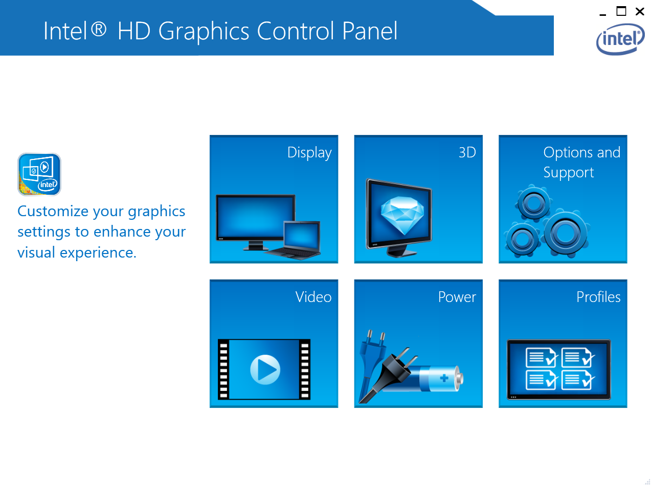

This is what you see as default in HD Control Panel when you first open it:
]http://i.gyazo.com/45d4d58f51d27b6cd4cd8e4fc7cead7c.png[/img]

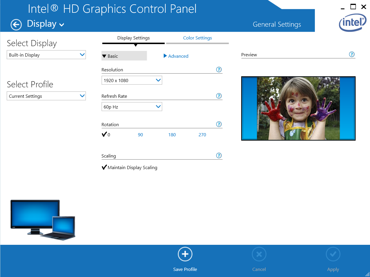

and selecting "Advanced" gives you this:
]http://i.gyazo.com/7f9db2677634d745af373673ed2d3274.png[/img]
You have to hit that white arrow in circle on top left corner to go back to this:
]http://i.gyazo.com/c3909ff4ecdfea485b88a5585f352de1.png[/img]

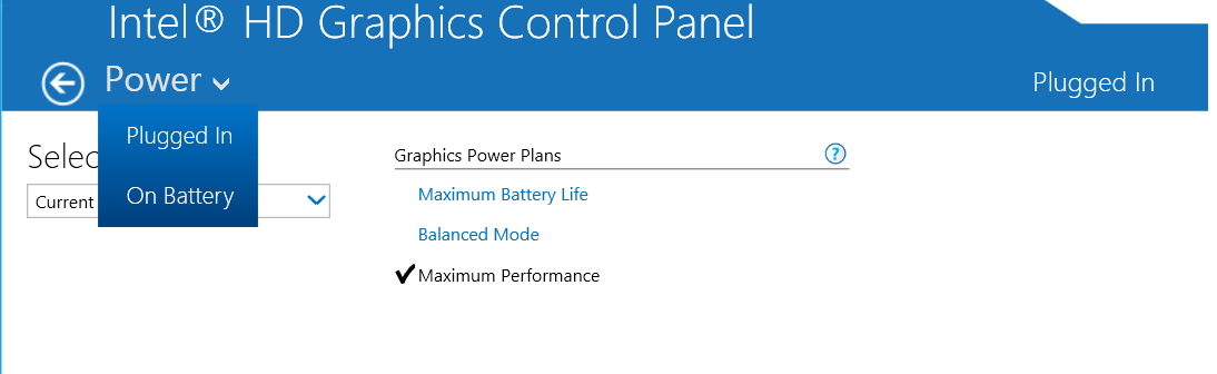

Then hit "Power", then select On Battery which is not very obvious:
]http://i.gyazo.com/eb91b863218520091f7989560cc4437f.png[/img]
and disable the Display Power Saving Technology:
]http://i.gyazo.com/651e2c6c0d743e6cfb63b9e9b0cfea39.png[/img]
