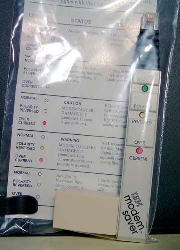

Actually, I was waiting for them to arrive (on 7/24) before saying anything, but since you posted a link, I'll say now that I already bought a lot of 5 brand new Modem Savers - IBM Brand - 73G5395 - which cost me a total of US$12.80, which works out to $2.56 a piece.
I'd like to keep one and one spare, so thinkpads.com members can PM me and I'll sell the other 3 at my cost - $2.56 plus the cost of shipping to you.

Naw, certainly no secret - I was just going to wait until I received the items and ascertain they were "as advertised" prior to posting - but I posted about it because I want to prevent members from spending significantly more money on aftermarket testers when they can get a genuine IBM one for only a few bucks.
And I do appreciate your help in finding something to do the job for us.
UPDATE: They just arrived and here is a picture (the other object is one of those adapters that connects two phone jacks together, so if the end you have is a plug, you can still use the tester... those adapters cost several dollars each at stores by themselves
