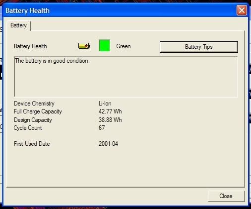

I just finished replacing the LI-ON cells in my T21 battery. Dangerous, yes. But I did my homework first, and knew the dangers/cautions/warnings.
I ended up with the same cell size (18650) but a higher density.
The battery new was originally rated at 38.88Wh according to the battery information screen. It now reads 42.77Wh, and estimates the TP will run for about 4.5 hours. Much better than the 5 minutes I was getting.

That would require writing/clearing a specific area in the battery's memory chip. Without having a data dump of said memory or the means to write into it, I'd say just live with an incorrect counter. If and when you sell the battery, it could be an asset (Wow! 954 cycles and it still has that much of a charge! That's great!) or a liability (Wow! 954 cycles! No way I'm buying that!).

It reads 67 as the count, so I guess I'll keep my mouth shut.
I ran the laptop on battery alone last night and after 2 hours of surfing and google video/you tube crap, the meter read 72% remaining with an estimated 3:05 hours left.
