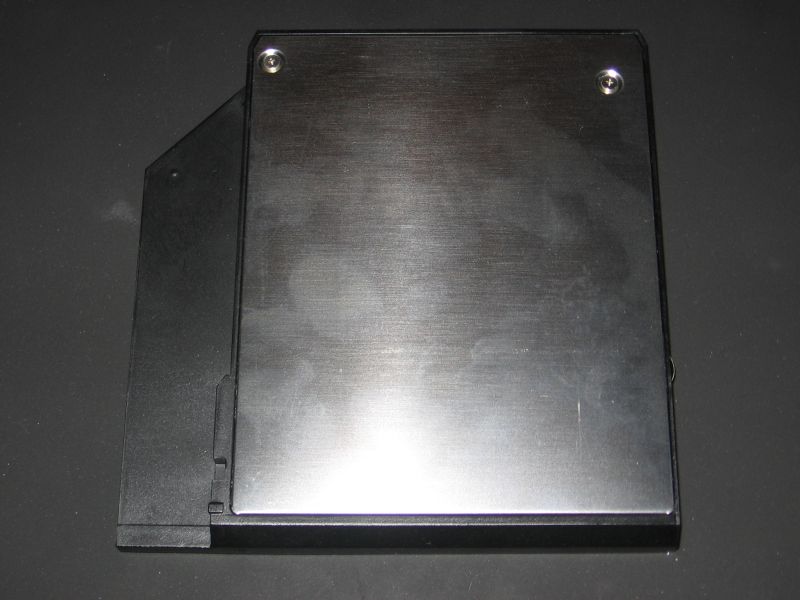

I just received what i thought was an OEM Ultrabay Adapter but i can see it's probably not. It has a RED LED instead of the usual green and it sticks out about 1mm from the UB slot.

Neither one. I pretty sure that the genuine IBM HD adapter has a solid metal tray where the HD sits (i.e., no cutout or hole in the bottom), has metal on the top surface around the bay where the HD sits and has an IBM logo by itself (and not "For IBM").
At least that's what I have in my hand at the moment. I'll post a picture in a few minutes.

Posted: Mon Sep 10, 2007 2:19 pm
by SHoTTa35
well here's one:
I got one that looks like that but as i said comes with the RED led. It seems to have come in an original IBM Box too with the cutout in the foam and all that for it.
Oh man, here goes another HERE that looks official with the IBM box and all but he says it's not original IBM.
Does your drive stick out 1mm looking straight down at the keyboard?

My HD adapter (as pictured in the links above) has a green LED and does not stick out from the edge of the system. It looks identical to the one you posted above.

hmm well i see some differences:
http://img181.imageshack.us/img181/7181/image008na5.jpg
if you notice at the top mine has notches i guess while yours is a straight simple line where the IDE drive plugs in.

Yes, you are right about my adapter not having the metal "notches" just above the IDE connector. Everything else looks the same; the screw placements, the label, the printing and icons on the label, etc. Checking the feedback I left, I noted that it took 1 week from payment to receiving the adapter:
"Genuine IBM caddy in original box arrived in 1 week from HK. Thanks! A+++++"
In that T4X-T60 auction, the picture showing the adapter partially inside a T4x system appears to be of a knockoff :) .

SHoTTa35 wrote:IThis guy says his is OEM HERE
I have one of these. It works fine for a drive that is not in a caddy when inserted in a T4x Ultrabay Slim but doesn't work in a T6x Ultrabay Slim.... unlike my genuine IBM/Lenovo adapters, which works fine in both models.
