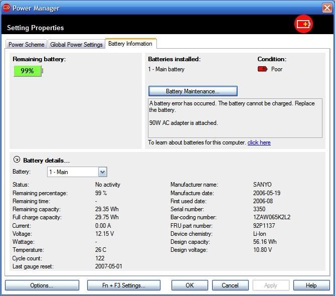

The same thing happened to my battery a while back. Fortunatly, It died soon enough that lenovo sent me a FREE battery. I used the one program from their website. You just need to search the lenovo website for Irrepairable damage battery message.
Here's a screenshot of what power manager said.
http://i282.photobucket.com/albums/kk25 ... attery.jpg
I took the bad battery apart and took out the cells. I charged them manualy so I could use them as a hobby battery. One of the cells had a lower voltage from the rest. I'm guessing thats why the circuity disabled my battery. As far as I know, you cannot "re-enable" the electronics to continue monitoring the battery.
