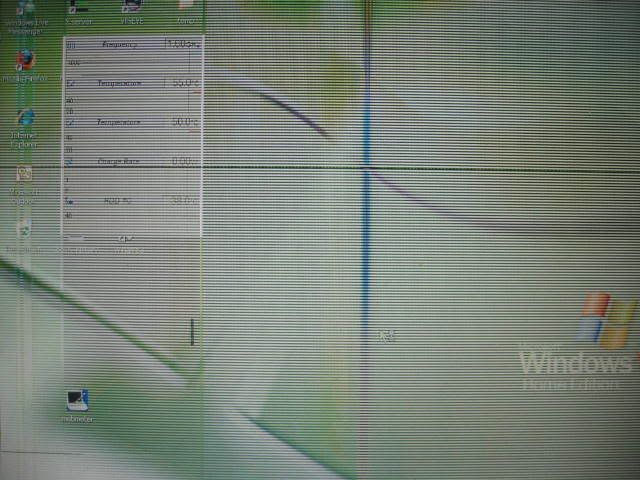

Below is a picture I took before the system died last time and this is how the screen looked like. It is pretty random but everytime the screen stuffed up somehow and then died.
http://i42.photobucket.com/albums/e315/ ... G_0097.jpg
