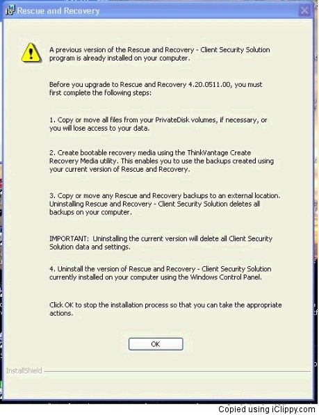

Folks,
It'd been a while since I made a back-up, so I decided to make an entire new one from scratch and ditch the old one. Not readily seeing in Rescue & Recovery (RnR) a way to simply delete old back-ups I decided to just re-format the existing partition on my USB hard-drive where I save the backups. I did that but now RnR won't see or back up to that drive (just a partition actually) - it returns a non-sensical error message admonishing me to connect my already-connected USB hard-drive.
Any advice on how to get around this? I'm running Windows XP Pro on a Thinkpad R40. Rescue and Recovery is v3.01.0042; I tried to download and install the latest RnR update (v4.2) from the Lenovo site but it won't install - it gives the following message about my needing to delete the existing RnR installation first, which "Add and Remove Programs" in the WinXP Control Panel won't do - it returns a bunch of garbage-messages about "Unable to install ..." when I'm not wanting to install - I'm trying to DELETE:
http://files.iclippy.com/109436/1251469465.jpg
While my ultimate objective is to get RnR to find my USB HD, I think the task at hand is to remove the existing RnR installation first, so I can then install RnR v4.2 - anyone know how to remove RnR outside of "Add and Remove Programs"?

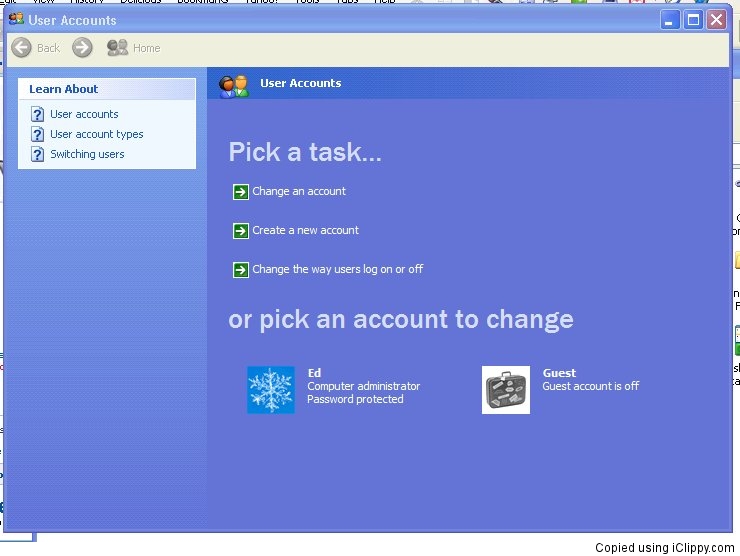

Killer,
Thank you for trying to help but I don't know why I'd be logged into my computer as anything other than an administrator - I'm the only person who uses it; I think the following screenshot confirms this:
img]http://files.iclippy.com/109436/1251473888.jpg[/img]
Also, I'm not getting any error messages about corrupted files; I'm getting idiotic messages advising me to use the Control Panel's "Add/Remove Programs" process to first uninstall the existing version of RnR before trying to install a new one, when that's exactly what I was trying to do when I got the error message!
I need a way to remove RnR that doesn't rely on "Add/Remove Programs".
