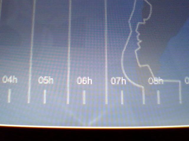

So I set up a new UXGA Boe Hydis HV150UX1-101 in a T43p frame and hooked it up to my spare T43p.
Comparing the two screens [the ID Tech and the 101]was interesting.
I thought my stock LCD[ ID Tech] was great until I put the 101 beside it.
The original [ID Tech] now looks "not as white" and slightly grays out on the left and right edges.
I only see these faults with both screens [ ID Tech and 101] side by side.
I dont notice them when looking at the ID Tech screen by itself later in the day.
But the new 101 has a couple of leaks , one at 06h and one at 01h-02h.
Can it be fixed?

malch wrote:Can it be fixed?
No.
Is the original panel ID Tech or Hydis?
I've heard several complaints regarding backlight bleeds/leaks on these -101 panels and am happy that I didn't get one myself...

the 101. seems like a tiny pressure point right at the bottom edge of the screen at 06h.

malch wrote:the 101.
Impossible.
It's either Hydis -100, or an ID Tech. That's all that one could find on a T43p.
-101 was never offered by Lenovo.

#6 Post by ajkula66 » Sun Nov 11, 2012 2:09 pm
I lost you there...
Let me spell out the question like this:
What is the *original* panel on the T43p, that "doesn't look so white" now?
I get the whole -101 business, as well as the topic that you've linked to and I had participated in.
There's no fix to the issue that you're seeing. Period.
If it bothers you, return the panel.

#8 Post by ajkula66 » Sun Nov 11, 2012 2:15 pm
If I were you, I'd:
a) Return the -101 panel
b) Swap the CCFL in the ID Tech (if it's getting very dark in the corners) or
c) Upgrade to LED-lit AFFS panel (which is what I had done on my own T43p)
Good luck.

#9 Post by malch » Sun Nov 11, 2012 2:34 pm
a: cant
b: see post 1
"The original [ID Tech] now looks "not as white" and slightly grays out on the left and right edges.
I dont notice them when looking at the ID Tech screen by itself later in the day."
c:"LED-lit AFFS" Ok, what is the part number you are referring to and I need the pinout
[Dec 1/12] got it:"Successfully installed ultra-cheap Hydis HV150UX2-100 (AFFS LED UXGA)"
http://forum.thinkpads.com/viewtopic.ph ... &start=300

#10 Post by ajkula66 » Sun Nov 11, 2012 2:38 pm
a) Why not?
b) See above
c) There is no pinout - you'd have to send your lid to RealBlackStuff, wiring for these LED-lit AFFS panels is utterly custom.

#11 Post by malch » Sun Nov 11, 2012 2:42 pm
a: she died of cancer
b: see "The original [ID Tech] now looks "not as white" and slightly grays out on the left and right edges.
c:proprietary then and not repairable or replaceable.

malch wrote:a: she died of cancer
That's sad to hear.
Fair enough. Hang onto that ID Tech then, I saved my original one as well.
It is both repairable and replaceable, but not by the end user... :twisted:
