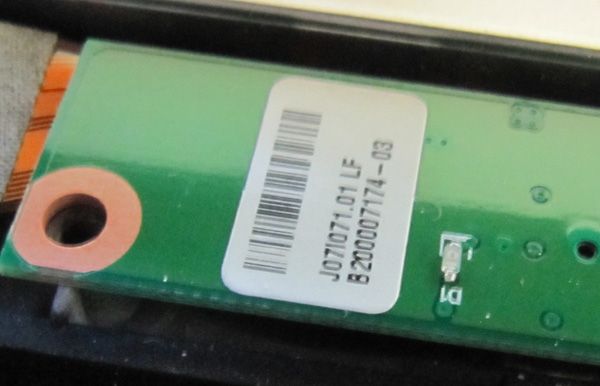

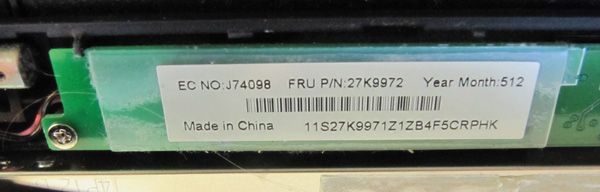

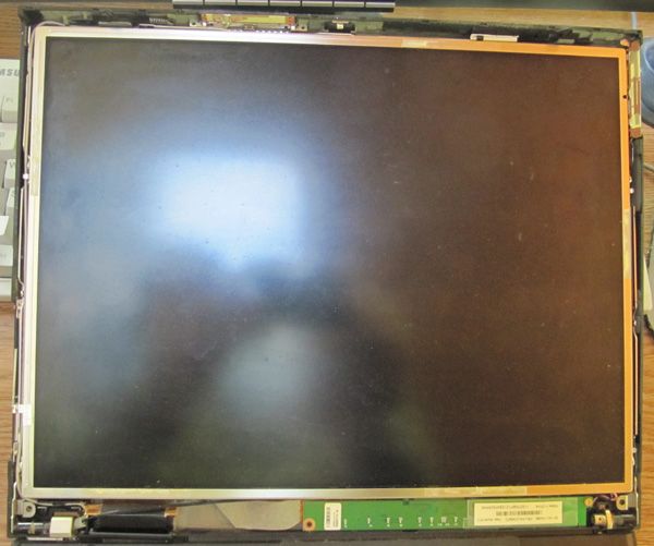

I took off the cover bezel in hopes of identifying which LCD panel I have in my 14.1" T43. I could not find the correct FRU to identify it in this list:
http://www.thinkwiki.org/wiki/TFT_display
I was hoping that one of the experienced members will be able to identify the LCD make from these pictures:
(Choices are: IDTech, Samsung, BOE-Hydis)
Inverter (label 1):
Inverter (label 2):
Overall view:
Invisible in the last picture, but there is 14P12B stamped on the aluminum LCD frame.
It seems to me that it might be the BOE-Hydis model: HT14P12.
Can anyone confirm?

- Posts: 15736
Re: 14" t43 LED backlight mod
FRU # as well as all the other info is located on the back of the LCD panel.
Well, I think i'm going to pull the plug on this project, due to the BOEHydis LCD. Unless someone's got a writeup or a video of the disassembly. Tried looking on ebay for T43 IDTech panels, but all I found were mostly Samsungs, and a few BOEHydises. Oh well...
