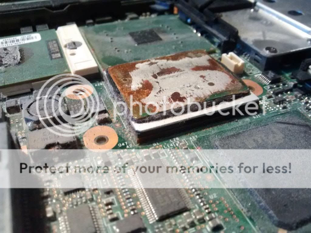

I bought a partially stripped T43p for its UXGA display, I knew the board was dead since it had a "DEAD - LCD OK" sticker on it but this just blew my mind. It appears as if its been so overheated that the fan has burned onto the GPU (V3200). The fan split into two when I forced it.
I managed to score a PM780 though that's going into my T42 (Assuming it survived.) and the UXGA screen is getting transplanted too.
http://i452.photobucket.com/albums/qq24 ... 335e34.jpg
http://i452.photobucket.com/albums/qq24 ... 5bbc15.jpg
Plastics are used but still pretty decent. All of this for 29 USD (200 SEK) WHOOHO! UXGA!

Re: Have you ever seen anything like this?
It's not too unusual you get something like that on a T43 that has never had the heatsink replaced... that thermal pad between the silver-colored GPU heatplate, and the heatsink assembly always ends up bonding and puts up a good fight
I've usually had to twist the assembly back and forth-pivoting it on the GPU heatplate, and usually what happens is the thermal pad gets torn up, or the GPU heatplate comes completely off, and clings to the thermal pad on the heatsink, exposing the GPU's memory chips and GPU die. Although... looks like what's happened here is that the thermal pad instead decided to grab onto a copper plate that's a part of the heatsink, which is meant to apply better pressure onto the GPU. Geez... well, no matter since the board's no good.
Its like freaking concrete. I've worked with a lot of T4X machines over the years, and I've never come across something this bad. Sure, , like you say, it can stick pretty bad on occasion. But this is completely, utterly stuck.

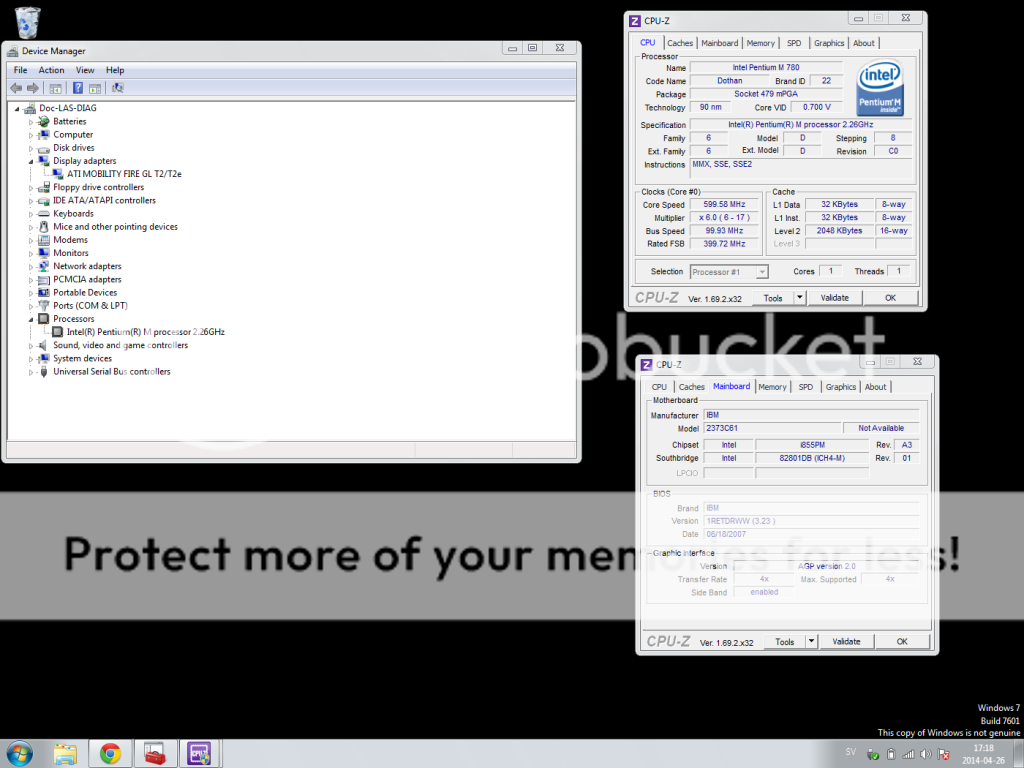

That PM780 will never work in a T40/T41/T42!
It's only suited for T43/R52.
They may have used thermal glue instead of thermal paste...
RealBlackStuff wrote:That PM780 will never work in a T40/T41/T42!
I'd normally defer to you on stuff like this, but this time you're wrong. It is not suited, yes. It is severely underclocked. But it works. As i'm writing this post on a T42p board with PM780.
Basic OOB config and you need NHC to get over 600mhz. I'm on battery atm. So its locked there.
You mean the white/printed aluminum cover on the GPU?
With thermal adhesive (such as from AS).
You can also clean up the inside of the alu shield and use AS5/thermal paste instead.
When you mount the fan/cooler, it will hold that shield in place and the screw that holds the keyboard from the bottom will tighten it even more.
Just remember it if you ever take it apart again.
I have never had the aluminum shield come off on any of my T4x GPUs, so I haven't seen this with my own eyes. But I understand that the 4-5 small ICs on the GPU chip are not the same height, so one of the ICs isn't physically touching the aluminium shield. So it was recomended by another user here to make a small piece of copper plate and install on the lowest IC, so even that IC can make proper contact with the aluminum shield. If this mod is worthwhile is unknown to me, and it is possible it gives the most result on a hot-running T43P. Any associated risks, as if the bit of copper gets dislocated and touches something on the GPU chip and makes a short, are also unknown to me. Just mentioning it, as I have put some thoughts into this for when I am going to dismantle my own T43P.
It's only happened to me on really old T43s that haven't had the heatsinks replaced in their lifetime, or for a long time. But sometimes it's good for it to come off anyways... because if you use your T43 for modern tasks, the GPU sees a lot more action than it did in 2005, so you'll want to scrape off the old thermal adhesive and put thermal grease there instead(basically what RBS up there outlined). I've done that on my spare T43p(not my prized one, I've left that original) and it does seem to help a bit.I have never had the aluminum shield come off on any of my T4x GPUs, so I haven't seen this with my own eyes.
For the most part, you're right: underneath the aluminum plate, this is what it looks like:I understand that the 4-5 small ICs on the GPU chip are not the same height, so one of the ICs isn't physically touching the aluminium shield.
http://www.pc-erfahrung.de/fileadmin/Gr ... ity_01.jpg
And the GPU die in the center is slightly lower than the memory chips. But the aluminum heat shield has an actual pressed lump in the middle, that comes down and meets the GPU die flush.
So, as long as you have all original components, you don't have to worry about cooling the GPU properly. You can try shaving off all the old stuff, and putting new thermal pads on and thermal grease, but it'll only help so much.
Ah, ok. As I haven't seen the aluminum shield off, I wasn't aware of the pressed lump. In that case the purpose of the copper plate wouldn't be that big. So it seems like my actions will be limited to applying new thermal paste. Maybe replacing the thermal pad with a copper plate could be a more worthwhile mod. I will do some experimenting.Medessec wrote:And the GPU die in the center is slightly lower than the memory chips. But the aluminum heat shield has an actual pressed lump in the middle, that comes down and meets the GPU die flush.

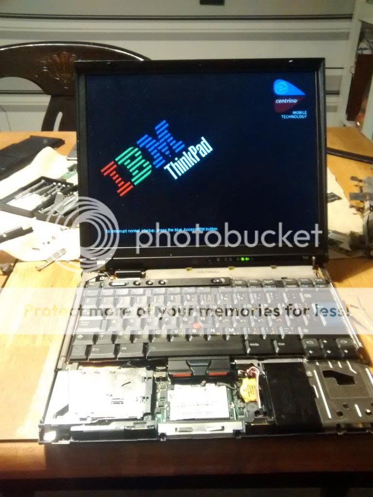

ITS ALIVE.
Threw the board into a 14" SXGA+ chassis I recently acquired. Lets just saw it got lost during inventory. Or fell off the back of a truck. Whatever strikes your fancy.
Pardon the kidnapped kitchen table. I normally have a proper place to work on computers but the power was out.
http://i452.photobucket.com/albums/qq24 ... 2525a4.jpg
