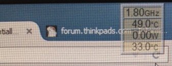

Here's an example of what MobileMeter can look like:
Transparent Operation and Always On Top modes are enabled. This is running on an A31p. Top line is clock speed, 2nd line is CPU temp, 3rd is charging system, 4th is HDD temp. I've set it to just display the values. There's an option to get graphical plots so you can see how the values are trending. I will have to say on very rare occasions I have seen the program eat up CPU cycles and I've had to kill and restart it. Maybe once a year but the system was also acting squirrelly anyway. I can't say if it was the cause or an effect. YMMV.
