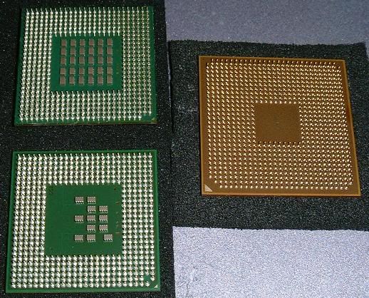

The top one is Banias which you are using (7x5); the bottom one is Dothan (7x0). The right one no idea
might be P-4?
http://i9.photobucket.com/albums/a80/ni ... s_back.jpg

We may be having a problem with semantics here, I'm not sure. If you look carefully at the pin-out on the image you supplied, in the lower right hand corner of the CPU's there is a slight variation in the pin-out between the two models:nirvana0001 wrote:I don't think so. Would you search their picture on internet? You will see they have different structure.GomJabbar wrote:You could get a range of CPU speeds that would work for each model, but they had to be the same form factor and design.
"The top one is Banias which you are using (7x5); the bottom one is Dothan (7x0)."
My point is: even though you may be able to physically plug the processor in the socket - which I doubt, these processors are different form factors and design (families: Dothan, Banias, etc.) (perhaps I'm not using exactly the right term here).
Each processor family (ie. Dothan, Banias, etc.) has a range of speeds (Ghz) that Intel offers. Generally speaking, as long as the BIOS and motherboard supports the speed, a processor of the same family or (form factor and design) can be used.
I believe that sometimes processors may have the same form factor (size, pin-out, etc.), but electrically they aren't compatible. But generally speaking, Intel does tend to change the chip design so that you can't plug the wrong processor into the motherboard.
