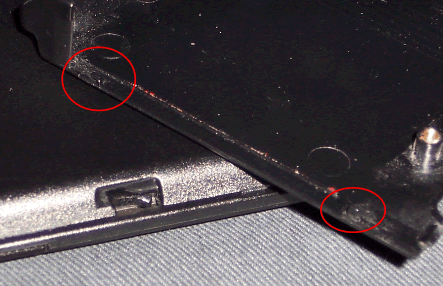

Although, the problem with the creaky palm rest is really the flimsiness of the palm rest, the creaking on the thing is really caused by 2 pieces of plastic rubbing against the base of the palm rest.
I actually bought a new palm rest to get rid of the creaks on the left side, and the new one had the same problem...So, I started looking at the built in more detail and I finally figured out that the creak is caused by the two little latches (which don't latch) that are to support the palm rest...
These ones: http://www.josesandoval.com/images/ThinkPadPalmRest.gif
So, I grabbed my swiss army knife, and I took little pieces off (mm really) so that the latches don't touch with the base. These latches don't really do anything, since the palm rest doesn't fit properly, anyway. Well, at least on mine they didn't do anything, except rub, creak and annoy the hell out of me.
After this procedure, my palm rest is creak free. The lactches are located here: http://www.josesandoval.com/images/Thin ... mRest2.gif
BTW, you don't have to take the palm rest to get to this little latches. If you lift up the palm rest, you'll see them.
BTW2, play with your thinkpad at your own risk. This solution worked for me, and didn't seem to do any damage - However, you may not have the surgical precission and dexterity I posses to maneuver a swiss army knife
So, I'm not saying do it, I'm just telling you what I did and what really causes the creaking palm rest - Ok, the creaking of my palm rest...

I fixed the creaking palmrest by putting a tiny little bit of "UHU tac patafix" on those latches.
This "UHU tac patafix" is like plasticine but gets adhesive after time when under pressure.
And best of all, you can always remove the palmrest without damaging anything, and it's not visible at all (palmrest doesn't bulge, and the plasticine isnt' visible either)
Maybe not the optimal solution, but IMO it does everything it should. Very nice to have a creaky free palmrest.
