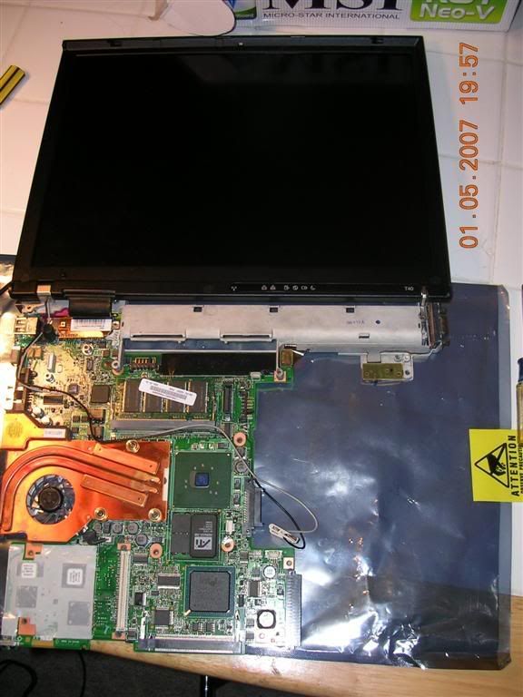

Thank you for this information! I successfully reflowed my bga video chip last night and let me tell you, it was scary!
First off let me point out these two videos of people doing this to their xbox 360.
http://www.youtube.com/watch?v=T5nfmJTQJr8
http://video.google.com/videoplay?docid ... 0fix&hl=en
I’m assuming they did this on the high setting because I had a problem getting my temperature to go above 190 degrees without getting the heat gun right up on top of the chip.
Disassembly of your laptop. It’s the service manual if you don’t already have it. ftp://ftp.software.ibm.com/pc/pccbbs/mo ... 192_01.pdf
If you notice on page 110 of this PDF there is a processor heatsink on some models that covers the video chip as well! I think if we could all get ahold of these it would not only prevent the video chip from getting hot enough to loosen, but help put pressure on it to hold it in place!
The fundamentals of bga reflow http://www.research-intl.com/reflowhand ... attach.pdf
On page 2 of this www.altera.com/literature/an/an081.pdf , there is a fantastic chart that basically covers how you need to go about hitting the correct temperatures. Here is an excerpt from http://forums.macnn.com/66/ibook-and-ma ... usb-logic/
Everyone should read this thread!
My process:
Make sure you know a round about temperature of your hot air gun. Start by practiving on an old pcb, I used a modem and played around with the temperatures until I was fairly comfortable with removing components.
First I disassembles my laptop completely to make sure that it wasn’t something grounding out on the case. I was able to support the mobo firmly by some plastic on the right middle, and bring it to the edge of the table and press down on the plastic covered area to get it to mess up. Even a small amount of pressure on the top right corner of the chip alleviated this.
Notice that you can have every component off the board besides the ram, proc, and monitor and it will work fine. Just be sure to WEAR A STATIC BAND!
Be careful when you remove the connectors, I pried this one to hard and had to resolder it.
Now, go to a cooking store and buy a digital thermometer made for the stove with a probe that can read up to 450 degrees. Fix that near the chip, but make sure it’s not putting pressure on any nearby components because you don’t want them to move when it get’s hot.
I didn’t use a piece of solder on the top of the chip because when I tested this on the modem, as soon as it formed a ball it went flying! So I choose the ground to the bottom right of the chip. I put a little flux on it and soldered the base, then built up some solder into a cone shape, when the air got hot enough, the cone formed into a ball, but stayed stuck right in it’s spot on the soldered ground.
With my heat gun on low, after heating up the rest of the board. I could reach around 180ish doing small circles over the video card. If I switched it to high the blob would instantly melt and I would need to pull the heat gun about a foot away from the board to maintain 180 temp. I found I had more control close up, but was afraid of the hot air blowing components away.
Insulate everything with foil and peel off any surrounding plastic. I found that just curling some foil over the little plastic connector kept it plenty cool. This pic is from my first unsuccessful run, later, I cover everything but the video chip.
I cannot stress how important it is to have a digital thermometer in there! All in all, I probably had this thing up to 215 C for about 15-20 seconds and it works fine now.
When you are done, you can test without putting the board all the way back together, and try again if you need to. I left the temp gauge on it and let it cool to about 100F before I started stress tests again. Also, DON’T forget the white plastic lining on some of the chips if you took it off. This can short out your board or at least stop it from powering on.
I also put some support in the case under the keyboard by tearing up strips of shipping label paper and folding it, sticky side out. It took three stacks of these to make it the right height so that the spacebar would not stick. Be very careful with the positioning, you don’t want your ribbon cable to melt on the video card, and you don’t want it to be tight or twisted by the pressure, causing premature wear.
Sorry this is long and not very well structured, I’m tired from being up all night playing with my new toy

Re: Another succesfull reflow... WARNING: IMAGES
Nice pic of bottom of BGA chip for anyone interested.
I thought of using a weight, but the way BGA's work is when you get them hot enough (evenly!) they will re-align themselves. So i don't think the weight is necessary. If you DO want to use a weight, i probably wouldn't use anything that weights more than a few grams. Something like a large washer, nut, or maybe even as large as a watch or a sink aerator. It would also need to be perfectly centered to avoid the original problem.
Also, i'm going to try and purchase a "Long" version of the heatsink off ebay tonight. I think this, combined with added reinforcement, may be the key to preventing a relapse.

thanks for a very informative article, willpower. i hereby no longer support my own idea of using a metal chunk as heat-source.
for your info, i have the long fan as you show in the picture. yes, it helps by making it press firmly onto the GPU, but still its not a permanent fix and chassis-flex still jams the pc. on the other hand, this should be balanced by the risk of doing some permanent damage to the system board using the heat-gun-trick.
my only worry now is that it seems as if everyone is successful in using the heat-gun technique, so i'm sure when i try it ill pull statistics in the other direction. isn't that how things work?!?
nevertheless, congratulations on a successful fix and thanks heaps for a thorough and useful article!

yep it was 140grams worth of battery - distributed over 696 pins (is it not?)willpower101 wrote:That sounds scary to me. Are we thinking of the same thing? Those giant heavy batteries that go in flashlights? It seems like that might be overkill and flatten out the solder. I'd also be afraid of the solder spilling over into the other channels. At least you'd definitely know when the solder melted as the chip sinks flatjjames55 wrote:...putting a "D" cell battery on top of the GPU...![]()
But firstly i dont think this method ever melted more than the outer two or three layers of pins, it would require the heating up of the whold package or enough air flowing in under the whole of the chip which i dont think happens - esp with this battery on top...
But at the sametime i also think the solder breaks from the flexing must be somewhere in one of the outer 'squares' of balls thus making fixing this way poosble.

Folks, that flexing of the keyboard is wrong. The problem is the too short well soldering of the BGA arrays during manufacturing. There are hundreds of small balls to be soldered underneath the graphics chip. During stress (i.e. heat when GPU intensive things happen) and different thermal properties of the components, the BGA chips can loose a few contacts to the mainboard. Therefore by pressing it or using a wedge you can reconnect again.stuckj wrote:I seem to be having a similar problem with my A31. It's about 4.5 years old. Replaced the mainboard last year as the graphics chip died (along with a host of other power-related problems). Now the graphics are on the fritz again. I disassembled it and noticed that flexing the board slightly around the GPU temporarily fixes the graphics.
There are a few DIY solutions I've found on the web for attempting to reflow the solder on the BGA. I was gonna try it out as I've got a new laptop coming in the mail tomorrow anyway...
-Johnny
Usually this problem is quickly solved with an industrial heat gun that uses extremely hot air to re-solder the BGA. You don't need a new mainboard. the whole process takes a few seconds and gives lasting success.
Unfortunately these hot air resolders are industrial and expensive, so you would need to go to an electronics outfit for help.
If you google for Apple G4 iMacs or Sony GRX notebooks, all with disconnected GPU chips you would stumbel across a page where a hobby technician did some good repairs using a tea light with alcohol. He put it with good physical contact on the ATI chip, heated it up and the problem was permanently fixed.
The main problem is the very large area underneath the BGA chip which makes industrial soldering a problem. The Intel CPUs are housed in a socket, so generally no problems occur because there is enough space for the pins to thermally expand and dissipate heat. Most GPU problems occured with systems that don't use a thermal cooling system (T40, R40 with short fans).
Just an engineer's comment here...
- Posts: 10052
Sorry for this engineer (memory test) to disagree with another engineer, but chassis flex (not keyboard) IS probably a major contributing factor to loose and/or broken solder balls underneath large BGA components.
Not sure what you mean by "too short well soldering" but if you are referring to an incomplete reflow of the solder due to, 1) lack of enough time or 2) lack of high enough temperature or 3) both, then the board should have failed initial inspection, which I hope IBM/Lenovo would be doing, or at some other point in the quality control process. Yes, the GPU gets hot. But hot enough to melt the solder (~185C)? I wouldn't hope so.
Yes, there are different thermal expansion characteristics involved here. A plastic or ceramic encapsulated integrated circuit has a different coefficient of expansion when compared to the printed circuit board (PCB) it is mounted on. Because almost all the components used in today's (b)leading-edge equipment are using surface mount technology (SMT), we are seeing more of these failures. However, because of this usage of SMT, there is now also the concern of mechanical stress (i.e., flexing) causing failures. There are many reports in the forum of certain components lifting off of the board which ARE NOT subject to, nor emitting large amount of heat.
There is also the problem of lead (as in the "leg of the part", not the chemical) contamination leading to the separation of said lead from the circuit board. In this case, flexing of the PCB breaks the loose bond that has occured.
Yes, hot air reflow can solve this type of connection issue. "vlyne" and I were discussing this back on 12/17-12/18 in this very thread. Go back to the second page in this thread and read what I said there.

This has been a question bothering me for days since it's been fixed. I haven't taken it back apart, but i noticed there was room for the board to move in there. I think possibly putting rubber supports in key places would help prevent this. Mine seems to flex the most from bottom left to upper right, and is much stiffer the opposite way.teisole wrote:how does one prevent this in the future? i dont think it is optimal to re-solder the GPU and keep your fingers crossed that it is "strong enough" to absorb stresses due to chassis flexing.
has any of you found a - or thought of - a clever way to make the chassis stiffer? or prevent the GPU part of the system board from flexing?
As a side note it's still working perfectly; and i'm a ROUGH user. I use this thing in the car on the passenger seat a lot. (not while driving) I tend to treat my personal laptops more like a book than a delicate machine, because that how i need them to be. I've always been like that and never had a problem. Every time i pick it up by a corner or something where i'm not fully supporting it, or rest it on one knee, i wince hoping this won't be the one that does it in, but so far so good!
