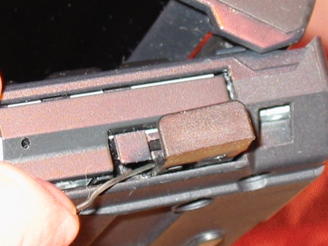

There could be a couple of things going wrong here... If the Ultrabay Slim is constructed the same as the Ultrabay 2000, then:
1) There's a threaded insert in the bottom of the lever which can be secured by a screw. I'm assuming that you aren't using the screw
. The threaded insert can fall out (part way) and prevent the lever from popping out. Check to see if this is causing the problem. If it is, you can push/pull the threaded insert with a straightened-out paper clip or small screwdriver.
2) It's possible that the plastic slide has broken, prevent the lever from ejecting. You can manually release it by poking a paper clip in from underneath the Ultrabay drive and next to the release lever. I'll see if I can post a picture of the technique I use.
edit: Okay... here's two pics...
Closed
Open
Closed
Open
Nope, the Ultrabay slim is totally different from the Ultrabay 2000 (I've got machines with each of them). I've always had the DVD drives for each of them come out very nice and easy, but that hard drive adapter in the Ultrabay slim is caught up on something - if I could even tell where it's stuck I might be able to get it out, but I can't.
