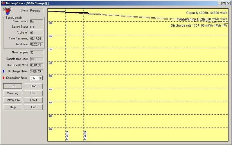

What is your average wattage for your T4x when using battery?
as for mine, average with
15W (wireless connected, 3 bar brightness, light file transfering)
17-20W (wireless connected, 3 bar brightness, heavy file transfering)
battery can last for 2.5 - 3hrs
(replacement from SONY recalled battery)
Cycle Count: 42
Full Charge Capacity: 47.91Wh
Design Capacity: 51.84Wh
Manufacturer: SANYO
Manufacture Date: 2006-10-18
First used date: 2007-04
Configuration:
T43,
1.86Ghz, 1G ram, 6cells battery, 80G HD 5400rpm
running at 0.7v@800Mhz (RM CPU clock utility)
Cycle Count: 42
Manufacturer: SANYO
Configuration:
T43,

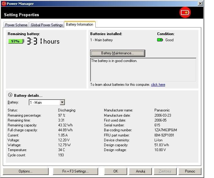

T43p
cpu 1,83
wifi on with medium power consume
bt on, nokia pc suit works
profile max performance
2g ram
60g 7200 rpm hd
lan on,
2,42a (1,31h)
27,29W
minimum
consumtion with off wifi and bt off
maximym battery profile
1,5A
18W
afer restart win xp 1,11A (over 3 h)
battery 200 cyles, panasonic 6 cell
br
cpu 1,83
2g ram
60g 7200 rpm hd
lan on,
2,42a (1,31h)
27,29W
minimum
1,5A
18W
br

with 27Wh still can last for 3 hrs?AdaSch wrote:T43p
cpu 1,83
2g ram
60g 7200 rpm hd
lan on,
2,42a (1,31h)
27,29W
minimum
1,5A
18W
br
2. X60s 1703-CA3 powerful
- Posts: 8368
- Location: Ann Arbor, MI
I am not that surprised. My R50p's 6-cell battery had about 29 Wh before reconditioning. When I reconditioned it last month, I had to completely drain it. I wanted to do it as fast as possible, so I cranked its 15.0" QXGA display (which consumes more power than smaller screens with lower res) brightness all the way up, surfed the internet over WiFi, and played a movie DVD. Despite all these demanding tasks, the battery still lasted almost two hours.gunston wrote:with 27Wh still can last for 3 hrs?
2668-g4ggunston wrote:Adasch,
what is your thinkpad configuration?
Original description: P M 750, 1GB RAM, 60GB HDD, 14.1 SXGA+(1400x1050) TFT LCD, 128MB ATI FireGL V3200, CD-RW/DVD-R Multi-Burner, Intel 802.11a/b/g wireless(MPCI), Bluetooth/Modem(CDC), 1Gb Ethernet(LOM), UltraNav, Secure Chip, Fingerprint Reader, 9c Li-Ion, WinXP Pro
but I buy 1G ram more and exchange battery from 9 cell to 6. I have sec t43p 2668-g4g (with 9 cels work over 5h) and t40 with 9 cells. 9 cell bat is too big and too heavy.
br
