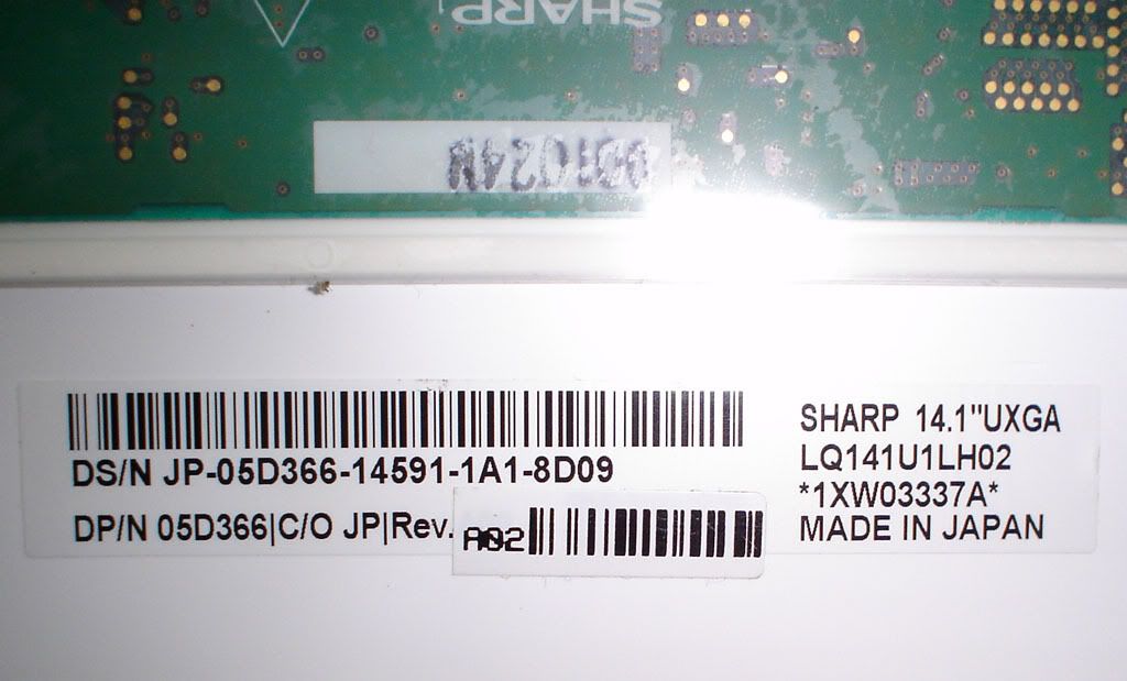

UPDATE #2: If you want to buy just the LCD, look for Sharp LQ141U1LH02, as shown in this photo:
http://i198.photobucket.com/albums/aa13 ... chUXGA.jpg

I added a photo showing the part numbers on the back of the LCD panel to the original post.
