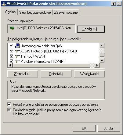

Hello,
i too have problem with ft+f5 but in t40
i found solution for me, maybe this help You too
check or uncheck some boxes on this tab. I don't remember what exactly help me but some box from this tab (probably aegis)
wlan card properties
br
br
