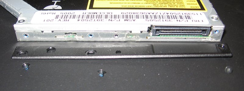

Ultrabay Slim, as in your T42p, accepts 9.5mm thick optical drives. I believe that the 11.7mm drives would fit inside an Ultrabay Enhanced, but not the Slims. Here's a couple of pictures from a 39T2505 Combo drive I have in my T41:
http://www.kawakami-ca.com/image/ultrab ... _drive.jpg
http://www.kawakami-ca.com/image/ultrab ... nector.jpg
The back plate is held on with three screws. There's no "adapter" to speak of like on the Ultrabay 2000 drives. The drive will physically fit as long as the existing connector on the optical drive looks like the second picture (and you also transfer the 1" plastic latch on the right side of the drive). It's kind of hard to see, but the connector has a "blade" in the middle with electrical contacts on top and bottom. Whether or not the drive will operate is another story. I would assume that it should as long as the drive is set to "master" or "cable select". My understanding is that some drives are set as "slave" and therefore may not work in the Ultrabay. I've adapted many 12.7mm (Ultrabay 2000) bare drives, including the UJ-820, UJ-840 and UJ-850 without problems.
