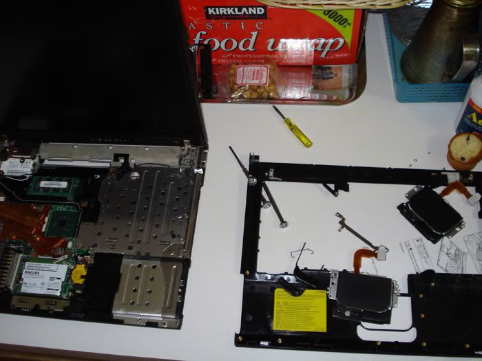

I worked on my kitchen counter.. my room was a mess .. excuse the random inserts of food in the picture =)

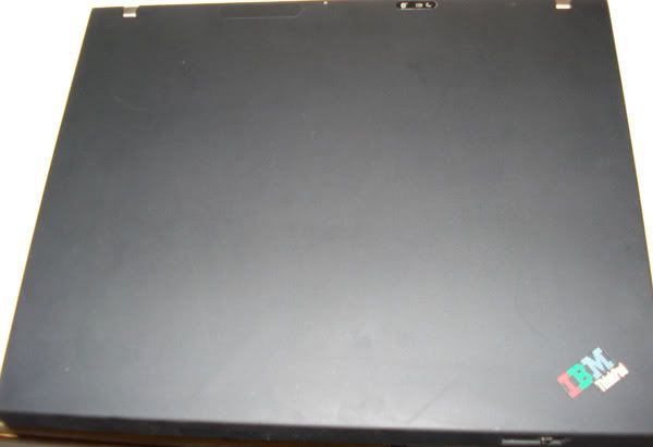

Here is the T42:
http://i128.photobucket.com/albums/p192 ... 42/t42.jpg

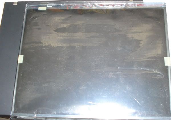

The new flexview!
http://i128.photobucket.com/albums/p192 ... exview.jpg

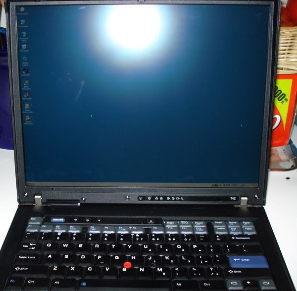

On and working with the SXGA:
http://i128.photobucket.com/albums/p192 ... 42sxga.jpg

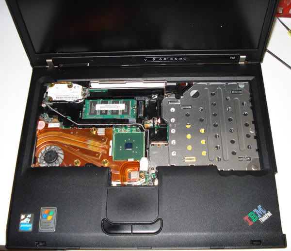

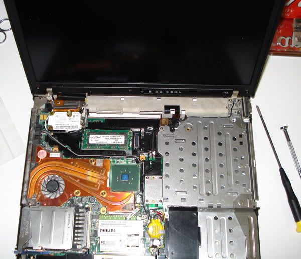

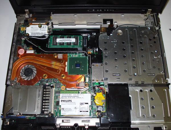

Starting the process:
http://i128.photobucket.com/albums/p192 ... /open1.jpg
Naked!
http://i128.photobucket.com/albums/p192 ... /open2.jpg
Swaping the mouse buttons/pad:
http://i128.photobucket.com/albums/p192 ... uttons.jpg

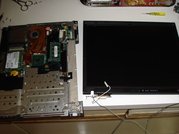

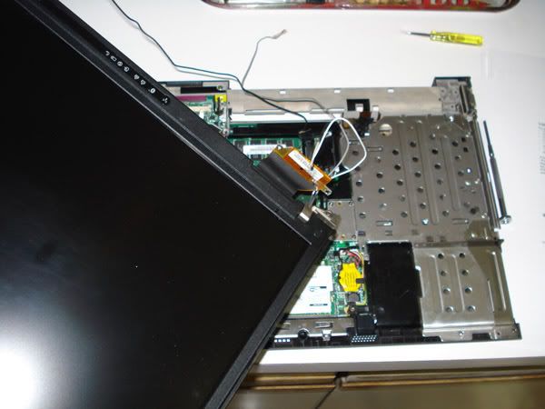

LCD coming off:
http://i128.photobucket.com/albums/p192 ... lcdoff.jpg
LCD off:
http://i128.photobucket.com/albums/p192 ... cdoff2.jpg
SXGA screen out:
http://i128.photobucket.com/albums/p192 ... lcdout.jpg
Flexview in:
http://i128.photobucket.com/albums/p192 ... viewin.jpg

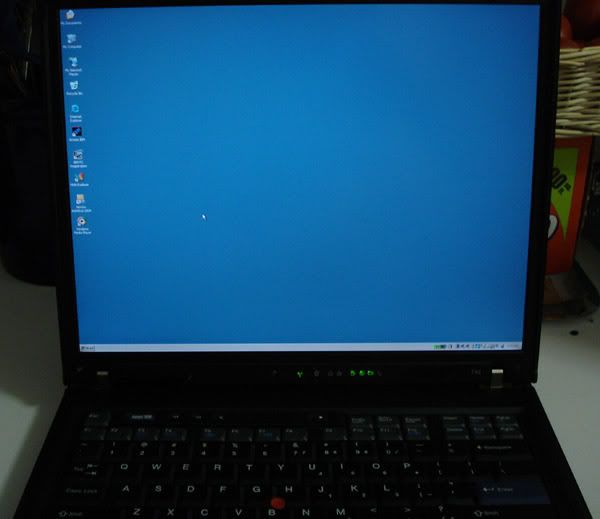

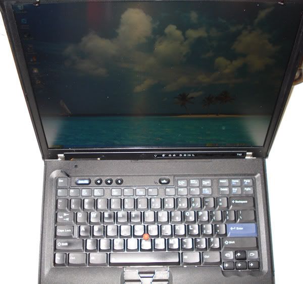

Finished!
http://i128.photobucket.com/albums/p192 ... /done1.jpg
Look 1600x1200 T42 yay:
http://i128.photobucket.com/albums/p192 ... /done2.jpg

Here is the T42:
Naked!

Finished!

I never took apart an LCD before so it was a first. I was surprised how only 3 of the standard screws held down the those heavy duty brackets ... I thought I was going to deal with bigger bolts or something ... It was fun overall.. just one hairraising part was when my screwdriver slipped when I was screwing in the mounting bracket onto the new flexview and it fell and I thought it scratched down the entire front of the screen! I gasped and then looked and there wasn't a mark. It must have JUST missed ... I would have probably cried if that happened haha...

BTW, your T42 had a FlexView to begin with-that poor broken SXGA+ was a FlexView. It is even more appealing now, of course, with UXGA.

Really? The screens seemed SO different. With both screens off, the 15" UXGA flex had a nice blueish hue to the screen, while the SXGA was just pure black. Also the colors are different.. I just double checked and yeah you are right, this was an IDTech 15" FRU 92p6680. Personally, i was able to see both screens side by side and the boehydis I put in seems to look so much nicer though =) .. So far I am glad I did it though =)ajkula66 wrote:BTW, your T42 had a FlexView to begin with-that poor broken SXGA+ was a FlexView. It is even more appealing now, of course, with UXGA.
