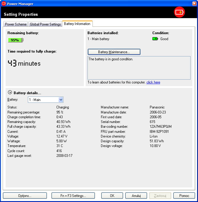

My battery is amazing
416 battery cycles in t43p
cheers

Nearly 84% of capacity after 2 years and 416 cycles is excellent.
Well done.

You have a Panasonic battery, which (i think) are the best.
I have a Sanyo battery in my T40, and it is nearly dead after 214 cycles (14.03Wh full capacity)

from what software is the printscreen in the first post of this topic?
thanks

IBM Battery MaxiMiser ;)

frankiepankie wrote:IBM Battery MaxiMiser ;)
not quite right, it's the thinkvantage power manager..
