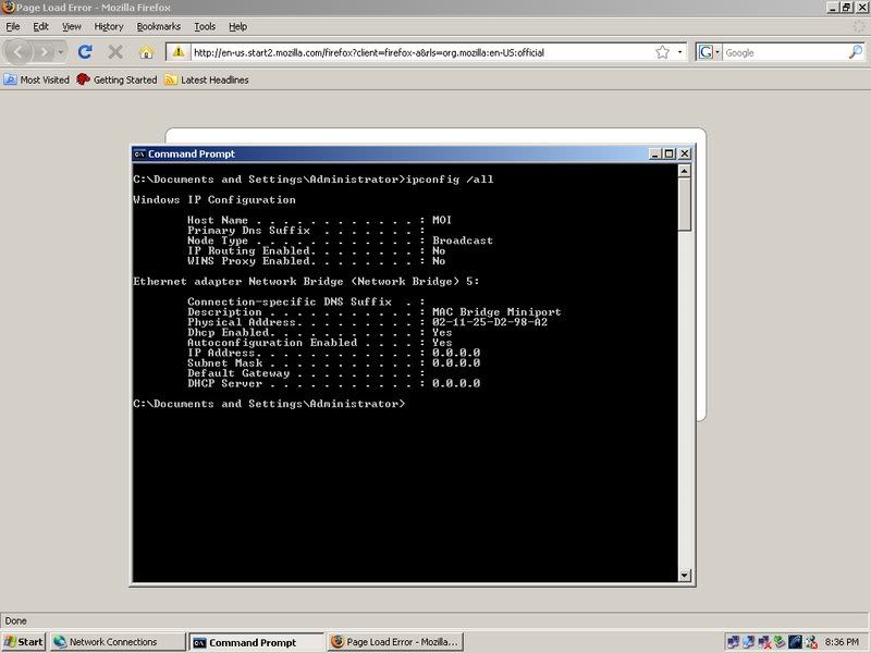

ipconfig /allHi again, didnt have chance to get back to this forum..
heres a screen shot of the ipconfig /all . The ethernet cable option works fine now bc i disconnected the bridge from the ethernet adapter. Hopefully someone here can fix my wireless problems!! =(
1) This first pic is when the ethernet cable is disconnected:
2) this pic is when its connected:

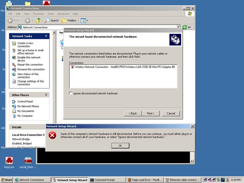

3) This pic is when i try to fix the wireless and setup a new connection with it, this window pops up saying my wireless hardware is disconnected or something. how do i fix this? i think this may be the key to the problem..
That's strange - IPCONFIG isn't showing up the Intel 3b wireless card (I've never heard of an intel 3A card). Some of these older intel cards have fried in utero so you could have a bad/flaky card.

HMM.. it cant be fried right? it was just used recently by the past owner.sktn77a wrote:That's strange - IPCONFIG isn't showing up the Intel 3b wireless card (I've never heard of an intel 3A card). Some of these older intel cards have fried in utero so you could have a bad/flaky card.
Should i take it out the wireless card and adjust something? use the blower to blow any dust? loose?
Any other ideas? Thank u so far though! I really want this fixed. Thnx
