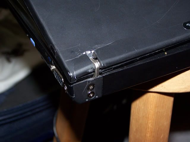

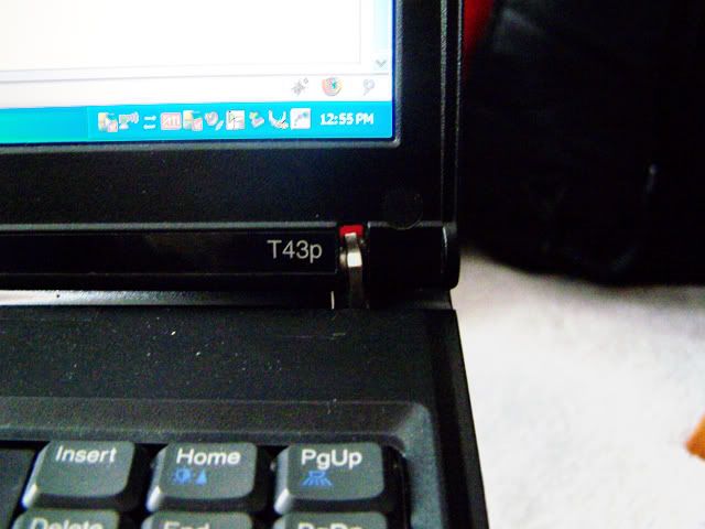

So my laptop fell almost 6 feet from a bunk bed, and the result is a broken left hinge (the one with wires passed through), a right hinge that looks skewed, and a cover that is mangled in the area of the two hinges. The power jack is also flaky now and wiggling the plug connects/disconnects power randomly. Figures I picked now to do this after my warranty ended in September.
I searched and found the manual and it seems like a doable fix. I assume I'll need 91P8388, the hinges, and possibly 13R2569, the lcd covers. Thinkpad-parts.com has each of them for $10.
I'm hoping someone can give me some insight on this fix and the parts and tools required. Are these FRU parts all I'll need? Do I need a new lid if I don't mind the cracked one? Is Thinkpad-parts.com genuine or should I be getting them from ebay? How about the power jack? I took some pictures and I'll link to them shortly to clarify what I'm describing.

EDIT: PICS
left hinge
right hinge
right hinge back
left hinge back

I wanted to update this after getting my thinkpad fixed. I ordered hinges and the lid cover from thinkpad-parts.com and they showed up quickly and in nice shape. I'd recommend them if anyone needs parts as the prices were lower than anywhere else I could find. The repair was not difficult and though I'm still left with the "loose" jack (it doesn't wiggle much but its sort of hit or miss trying to get it to actually charge, I can live with that.
