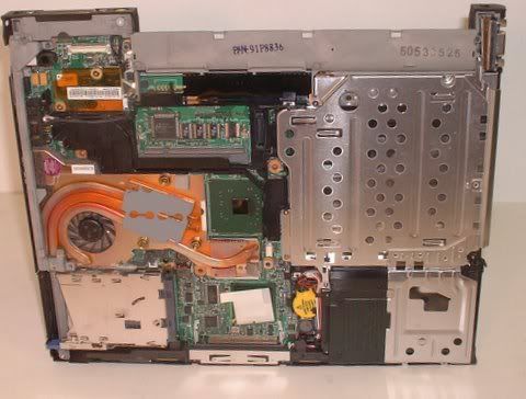

Darn, I just found out that the mobo I was eyeing on ebay is an Intel GPU, type 1871-CTO
The picture looks like this though: http://img.photobucket.com/albums/v295/ ... mbbase.jpg
This looks like an ATi GPU to me? I thought the Intel based boards had cooling on the northbridge because of the intergrated GPU.
Why doesn't the Intel GPU support the SXGA+ 14" LCD? :(

#6 Post by RealBlackStuff » Tue Jul 14, 2009 10:12 am
If you get an R52 Intel board, it does. I have such a machine, R52 1860-4QU.
It has a beautiful 15" IPS SXGA+ panel.
