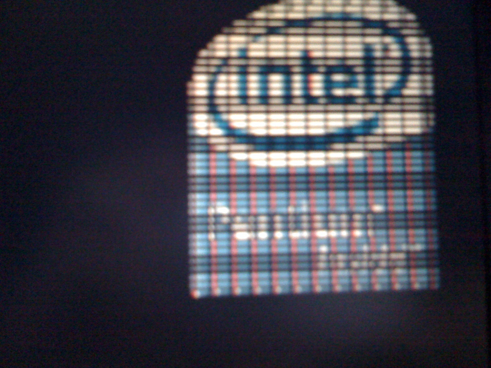

#7 Post by frankiepankie » Fri Jan 22, 2010 4:12 pm
Hmm should have read that earlier...
Already screwed it by heating up the GPU with an pen sized gas torch.
The image doesn't disappear now when i flex the laptop, but it has artifacts all over it.
http://tweakers.net/ext/f/OkDlWV80SjMqn ... Q/full.jpg
http://tweakers.net/ext/f/akLTt6I9Z8T5i ... P/full.jpg
That is another mainboard down the drain :(

poshgeordie
Posts: 1101
Joined: Sat Feb 09, 2008 6:19 pm
Location: Newcastle upon Tyne, UK
Re: Thinking about buying an 'defective' T42 motherboard, help!
#9 Post by poshgeordie » Fri Jan 22, 2010 6:21 pm
frankiepankie wrote:That is another mainboard down the drain :(
No NOT "another board down the drain" - it just needs reballing. I'm about to offer this service, and for a short time I'll be charging the same for a reball as a reflow.
Generally it's probably cheaper than buying another board of unknown quality.
