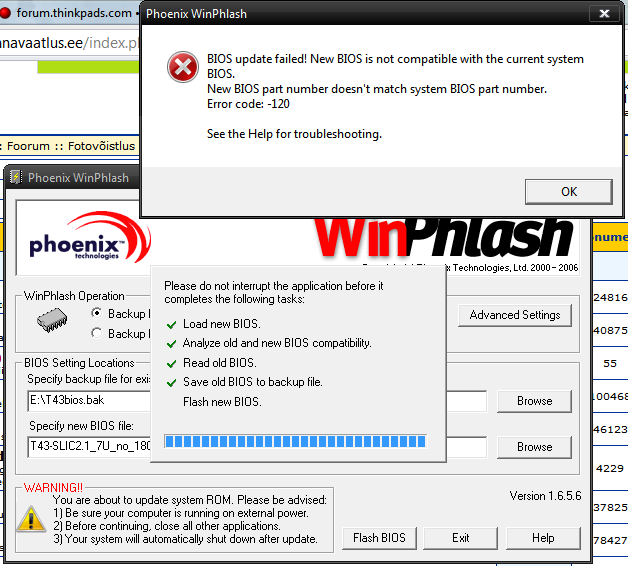

Re: T43 no more error 2010 (picture warning)
Downloaded that file. AVG didn't find anything wrong.
When tried to install it to my T43, I got error message: BIOS update failed. New BIOS is not compatible with your current system BIOS.
Everything seems to be working after first attempt, it just doesn't install the patch. Bios version is 1.29 which seems to be the latest for this machine.
What's causing this error. Do I have to downgrade or apply a mod to bios? Any ideas?
Win 7 and type 1871, if that matters.
6474AH5
Yep, it's with Intel graphics.
I was looking, but didn't saw any restriction on the type of machinery neither here or MDL forum.
6474AH5
top points wrote:Yep, it's with Intel graphics.
I was looking, but didn't saw any restriction on the type of machinery.
Yes there is:
oups!
@all T43 owners
common features:
SLIC2.1 Lenovo TP7U
Accept any WLAN card (no 1802 error, ender's solution)
No 2010 error
ThinkPad T43, T43p (2668, 2669, 2678, 2679, 2686, 2687 Machine types only)
Version: 1.29 (1YET65WW)
Release Date: 2006/09/06
I'm not worried because there's a version for 18xx machines.
Already downloaded and installed it. After one hour using i haven't noticed any malfunctioning, will report here as soon as something happens that might be related with mentioned bios patch.
6474AH5
