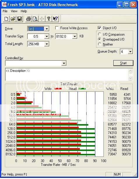

I just got my Ultrabay adapter, and I can confirm that it works like a charm.
I do not have a bios password, so I cannot make the drive loading first on start up, but F12 works like a charm.
All in one its a giant step forward in terms of performance - now my system starts in 10 to 15 seconds with some apps in start-up on windows XP SP3.
The only this that worries me a bit is the 4 kbyte performance.
