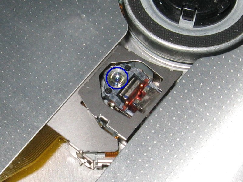

A related but off topic question about "cleaning the lens".
Do you mean the fragile clear plastic dome over the laser, or the glass-like cover under that dome? I've got loads of duff CD-RW's here and would like to get one working.

- Posts: 10053
Re: T42 and DVD-R
"Cleaning the lens" is a delicate, and generally final attempt that I make when trying to revive an optical drive. The only "lens" that I know of is the clear plastic (?) cover over the laser diode:
Click on the image for a larger (800x600; 100KB) photo.
A cotton swab dipped in isopropyl alcohol and gently brushed across the lens has recovered a couple of drives for me.
Click on the image for a larger (800x600; 100KB) photo.A cotton swab dipped in isopropyl alcohol and gently brushed across the lens has recovered a couple of drives for me.

Re: T42 and DVD-R **11KB PIC**
That's brilliant Ray. I've always wondered which bit it was since some of my duff drives don't have that lens and I guess is why they don't work.
After looking at your photo it's got me thinking about how easy it is to do a laser transplant from a known mechanically broken drive.
I'd guess that even if it looks easy the tolerances involved would have to be almost exact to allow it to function normally in the transplant target drive. We are talking about aiming a very fine point laser beam right?poshgeordie wrote:t how easy it is to do a laser transplant from a known mechanically broken drive.
- Posts: 10053
My understanding is that the laser assembly is "floating" and that it is controlled by a servo that maintains the proper focus. After all, the distance from the laser to the surface of the disk that has the pits and lands is continuously changing while the disk is spinning. As long as no damage happens to the servo mechanism, I would guess that such a transplant is possible.
