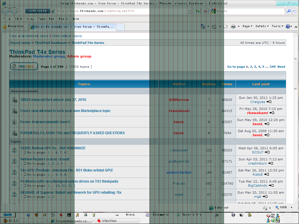

Striping of "broken" drivers (no D3D), 1024x768: http://i1192.photobucket.com/albums/aa3 ... oard02.png
Switching to 1280x768 turns the striping into a much more pleasant/manageable fullscreen speckling.
Any resolution with "working" drivers has an ugly checkerboard effect.

Your machine has fallen victim to the GPU becoming unsoldered from the motherboard. Sorry.

9600 and FireGL GPU's do suffer from from broken artifacts and I have traced that to damaged VRAM chips. Unfortunately it's next to impossible to repair, since the first challenge is to identify which of the 4 chips it is (no idead how to do that!) and to then try and remove it. Each chip is stuck to the GPU planar with black gung that is not easy to remove without damage to nearby tiny surface mount components.
Only solution is to replace the GPU. Note that 9600 (with 64MB on board RAM) and FireGL (128MB) are interchangeable BTW, but it needs a specialist reflowing company to do it because they aren't so straight forward to do.
