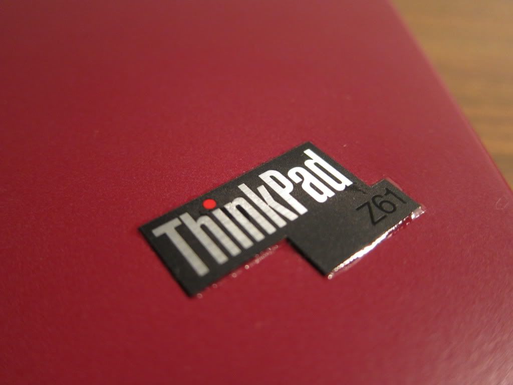

A zoom-in of the Thinkpad logo on the burgundy thinkpad:
http://i279.photobucket.com/albums/kk15 ... G_1376.jpg
The metal logo on the Thinkpad I ended up painting was all messed up. It was in rough condition before I started painting and the 3-4 coats of primer, 4-5 coats of paint, and 3-4 coats of clear coat made it look even worse. I tried to clean up the look a bit with an xacto-knife and only made it look worse. So I decided to cover it with a Thinkpad logo sticker. I used epoxy under the sticker to even out the surface (the raised IBM making it uneven) and improve adhesion. Unfortunately I got a small dab of epoxy on it below the "d" while positioning it, but its barely noticeable (unless you have eyes like a macro lens).
