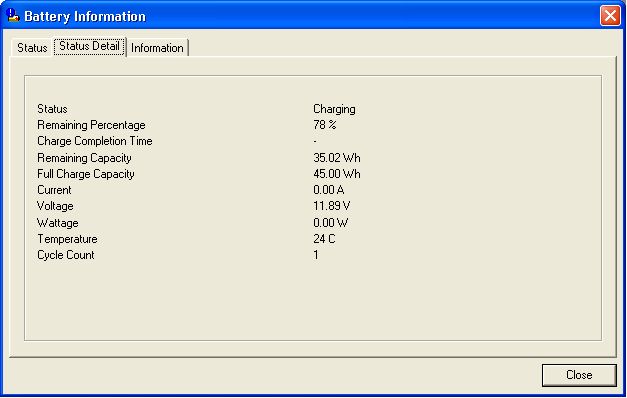

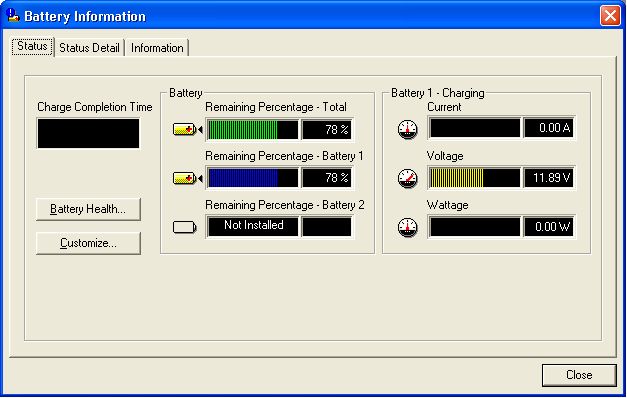

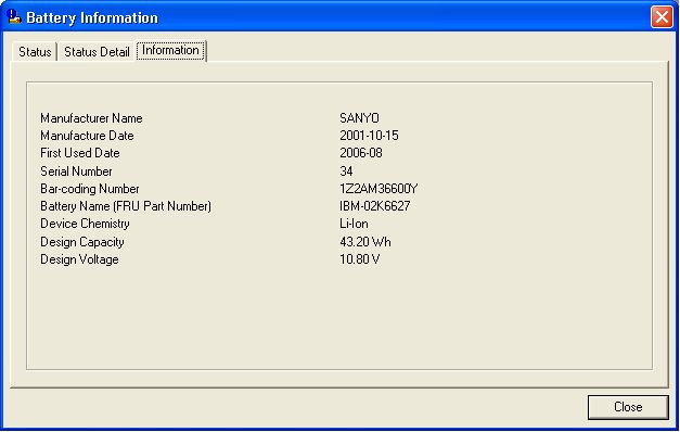

What does the Maximizer utility report under the "Battery Information/Status Detail" tab?
Links to the pictures:
http://i6.photobucket.com/albums/y224/r ... ttery2.jpg
http://i6.photobucket.com/albums/y224/r ... ttery3.jpg
http://i6.photobucket.com/albums/y224/r ... ttery4.jpg

Okay, looking at the first picture (battery2.jpg) you can see that the "current" bar graph is "zero". This indicates that the software does not read any current being supplied to the battery. The second picture (battery3.jpg) says that the full charge capacity should be 45Wh (watt-hours) and that the battery only has 35Wh, thus the 78% charge level. That picture also shows that the cycle count is 1 (brand new battery).
What you may have here is simply a battery that has not been discharged enough to warrant a charge. Typically you must cycle rechargeable batteries a couple of times when you first receive it in order to let the system calibrate itself. The (small) danger in doing this discharge cycle is that if there is really something wrong with your motherboard that is causing the battery not to recharge, then you will temporarily lose some of your battery's capacity.
At this point I would say try unplugging the AC adapter and let the battery capacity decrease to 50% and then plug the charger back in and see what the Battery Maximizer utility says.
(edit: I just re-read your last response... You say that you have both a yellow and a green light? Yellow on the left and green on the right? If so, the yellow light indicates that the system detects that the battery needs charging.)

Watching battery info for 1h or so (no, not all the time :) ,
it seemed that sometimes there is minimal current of 0.01 ampere,
but in fact the unltrabay battery isnt charged at all. (mathematical error?)
So i powered it down while it was still trying to load the ultrabay battery
That was an hour ago, the "ill" T23 did stay on the port replicator
the whole time, attached to AC.
Just powered it up again + status detail shows that its "charging" (again with 0.00A)
the main battery !
@Wrangler99
Can you repeat loading the 2nd battery in your T23 by that way , or was it just by chance ?
regards tom
