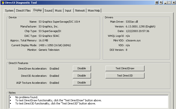

#6 Post by rkawakami » Wed Oct 03, 2007 4:36 pm
Have never fooled around with the dxdiag program on my T23 until now, so here's the info from my 2647-HNU:
http://www.kawakami-ca.com/images/dxdiag1.gif (18KB)
What is different from your setup is the display size (1400x1050) and color depth (16 bits). My system passes all of the Direct3D tests in both 16bit and 32bit modes. Also, my DirectX version is 9.0c (4.09.0000.0904) from the "System" tab of dxdiag.

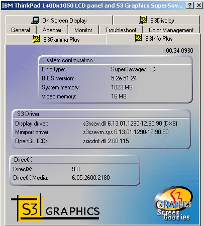

edit: OS is WinXPP SP2 with 1024MB of memory and as far as I know, the standard video drivers:
http://www.kawakami-ca.com/images/s3info1.jpg (47KB)

#7 Post by phool@round » Wed Oct 03, 2007 5:36 pm
It looks like your using the IBM supplied drivers Ray, I can tell by the extra S3 apps and the "On Screen Display (OSD)" tab.

To rkawakami:I already installed the dx9.0c. To compare your and my, I found the following differentiae.
firstly,my screen is only to support maximum at 1024X768. Yours has got a higher resolution.
Secondly,at the drive sector of dxdiag tool,your pic shows a ddi version:8. Mine is just n/a. :? . So could you tell me what the hell that means?
Finally,about the video self information, the major difference is about directx media version.(check the circle in pic)
And also you patched the sp,I didn't do it. So is it possible to cause the problem?
