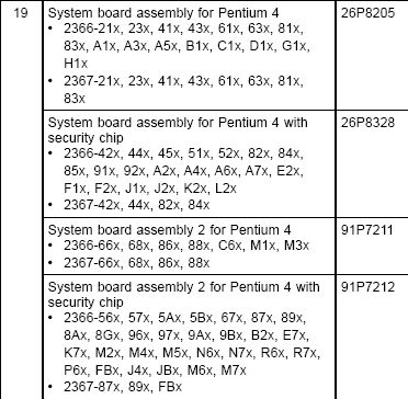

Hello, I have a T30 model 2366-43U that has a bad motherboard. The laptop has been great up until now and is in real great shape. I am looking to by a tested second hand motherboard off of e-bay. My question is some dont list the model number and some list the model but not the 43U part of it. Does it have to be the same exact number to work with my T30 or will others work. Thanks
- Posts: 10054
If you want to be sure that there's nothing in the way of a compatible swap, then you can check the Hardware Maintenance Manual for the T30 series. In it you will find this:
http://www.kawakami-ca.com/images/t30_mobos.jpg
It's a table listing the various type (model) numbers with the associated motherboard FRU.
