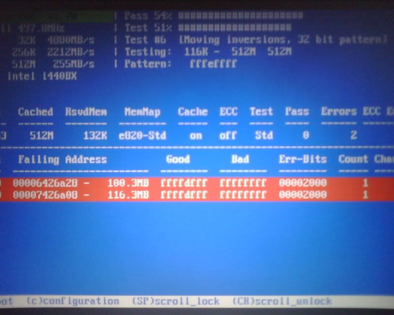

Thank you for the quick response. As an update, I actually got another t20 that I put the same modules into (2x256) and ran memtest86+ and passed just fine with 512.
I cleaned the pins with a pencil eraser and placed back in the initial t20 that was giving me the issues, and I received less errors, but errors none the less.
failing address- 00006426a28/00007426a08
good- ffffdfff
bad- ffffffff
err-bits- 00002000
count- 1
2 errors total
also, this time it took 53 minutes to receive these errors. So what I know now is that it seems to be pc specific due to not getting the errors on the new t20.
Is there anything I can try with the pc itself for this to be corrected?

The only things that comes to mind would be to make sure that all of the large bypass capacitors and inductors are firmly connected to the motherboard or use another set of memory modules. Let me explain and sorry for some technical details...
The screen shot you provided tells me that the module failed during one of the worst possible data conditions that the memory can be subjected to. First technical explanation:
Hexadecimal "ffffdfff" means 32 bits of data is being used. Each hex character (0-9,a,b,c,d,e,f) is 4 binary bits. Thus:
This means that 31 data bits are supposed to be a "1" and only one is supposed to be a "0". The "Bad" data is "ffffffff" which means that the memory diagnostic "read" all ones; even for the bit that was supposed to be a zero. The "Err-Bits" field confirms the position of the failing data:
Code: Select all
Hex ffffdfff equals binary 1111 1111 1111 1111 1101 1111 1111 1111Code: Select all
ffffdfff: 1111 1111 1111 1111 1101 1111 1111 1111 (Good or expected data)
ffffffff: 1111 1111 1111 1111 1111 1111 1111 1111 (Bad or read data)
00002000: 0000 0000 0000 0000 0010 0000 0000 0000 (a "1" means a fail in that bit position)From a circuit design point of view, the time when the most electrical current (power) is being consumed is when all of the data bits are going the in same "direction". That is, when they are all trying to go to zeros or ones. This stresses the power system into providing a large amount of current. That can cause a sharp, but very brief reduction in the voltage being generated. This is usually referred to as "power supply noise". These power fluctuations can be enough to either write the wrong data into the memory array or falsely read the wrong data.
