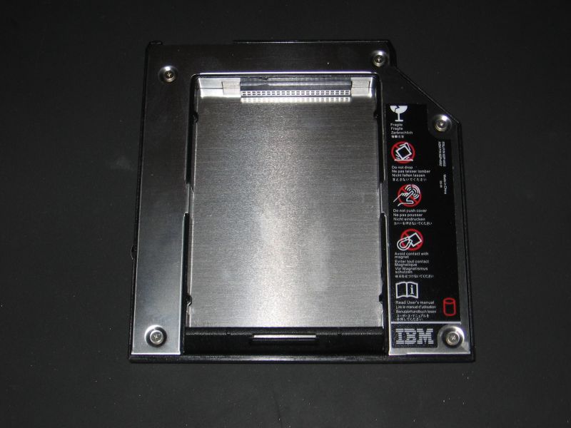

Can't be the same Ultrabay HD adapter. The T30 uses Ultrabay 2000/Plus and the T4x uses Ultrabay Slim.sarbin wrote:but the op says that the drive+adapter work fine together in a friend's t4x.

Probably like many other, I've read the original post a few times as well as the other responses, but it never occurred to me that the OP is trying to use an ultrabay slim HD adapter in a ultrabay 2000 slot. I blame IBM for this confusion.
(Lenovo will confuse people similarly with new ultrabay adapters for the R/T/W 4/5/700 machines that are incompatible with the R/T6x machines and vice versa).

No I don't think that's what dsbuck's is doing. I think the confusion started from when he said:
edit: It just occurred to me that you can use an adapter on an Ultrabay Slim optical drive and convert it to an Ultrabay 2000 device, but nothing has been said about this by the OP. If that's the case, ThinkWiki says that won't work:
http://www.thinkwiki.org/wiki/Ultrabay_ ... rabay_2000
and then...dsbuck wrote:Also, a friend was able to access the same drive/same caddy in his T-42
I originally read dsbuck's description of same drive/same caddy as being the hard drive caddy, not an Ultrabay adapter. You cannot physically install (latch) an Ultrabay Slim drive into an Ultrabay 2000 bay; it just falls right out. And you sure can't put an Ultrabay 2000 HD adpater into a T41! I'd say we have to wait until the OP returns and clarifies the Ultrabay adapter issue (bent pins) and Windows disk management settings.sarbin wrote:but the op says that the drive+adapter work fine together in a friend's t4x.

And here's several more images:
http://www.kawakami-ca.com/images/ub2k_vs_ubs.jpg (connector differences)
http://www.kawakami-ca.com/images/ub_sl ... er_top.jpg (Slim HD adapter)
http://www.rkawakami.net/ibm_t2x/ub2khd ... a_top1.jpg (2000 HD adapter)
