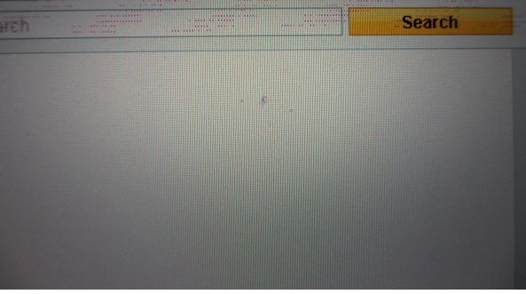

My old T60 (15" IPS screen) having a weird symptom, started a few days ago. In random parts of the screen I'm noticing red dots/dashes which do disappear once I refresh the screen (switch between windows or minimize/maximize the window). It actually happens more often on scrolling bars of the window, I guess darker parts of the screen? Other then that, screen brightness is OK. What could it be? LCD backlight acting out? Video card? Can't be a driver? Its definitely not permanent or pixel related because those appear in random spots, and go away after refresh. Any advice, please? What to try, how to test, how to fix? Thank you!!!

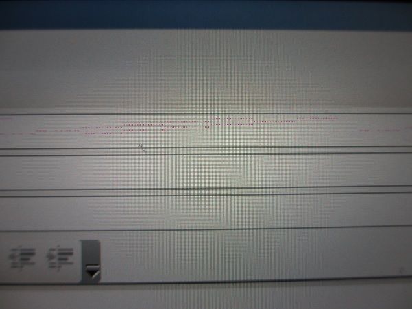

by twister6
Sorry for an awful picture quality, just quickly snapped up close of a few screen parts. You see a bunch of red dots, which disappear as you scroll the bar or refresh the screen, totally random stuff.
Re: T60 display - seeing red dots/dashes on the screen
Posted: Tue Sep 04, 2012 10:07 pm
by ajkula66
Yep. I see that.
And I'm 99% certain that it is what I stated in my previous post.
You'll need a new motherboard sooner than later, I'm sorry to say.
