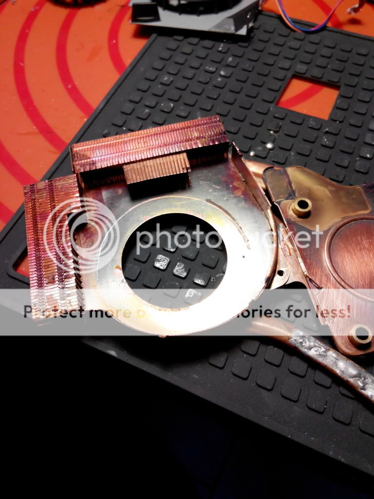

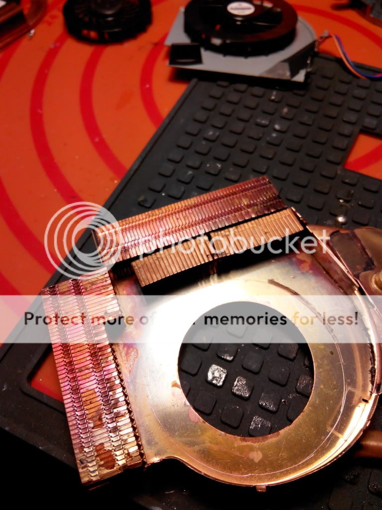

I developed this modification of the fan T61P to solve the known problem of the video card .
I think the main problem of the T61P is that the cooling system can not handle peak heat that produces the nvidia fx- 570.
this happens ' cause the heat conductor is too long and thin.
I had to add an additional thermal circuit taken from a x60
has been a difficult job with a heater air temperature , pond and lots of patience , with the heat all the conductors of heat detach and move.
to take the right steps I had to insert a motherboard T61P route in rollcage , mount the heatsink on and weld .
to -day I will come ' a new motherboard and can' test the system , I just wanted to share it with you all.
I also bought a panasonic thermal pads on the card is even better than copper , I want to use it instead of thermal paste .
http://it.rs-online.com/web/p/gap-pad-termici/7123992/
I expect that this work will work the T61P ' very low temperatures for many years ..

http://i943.photobucket.com/albums/ad28 ... 02b91e.jpg
http://i943.photobucket.com/albums/ad28 ... 3bfe8b.jpg

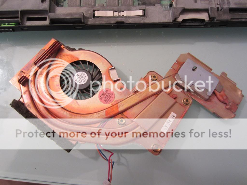

for clarity here is also a picture of the original heatsink
http://i943.photobucket.com/albums/ad28 ... f318c4.jpg

Interesting mod.
A for effort, but i think the mod will have limited use, since you delivered the heat from the additional pipe to the
metal right above the fan impeller instead of into the radiators. All that heat has to conduct through the fan body to the radiators.
I'm not saying it will do nothing, just that it will have a limited impact.

86turbodsl wrote:Interesting mod.
I agree, but unfortunately because of the space there is no way to add heating elements inside the impeller without disturbing the flow of doing nothing but damage.
however, we are talking about 3 mm from the copper heatpipe cooler, I think the impact will be 'heavy.
I noticed that the gpu is always working at a temperature of 16 or 20 degrees C more 'at the top of the CPU, a sign that the heat is not transferred to the fan quickly.
In addition to this, the gap thermal pad that I bought has a conductivity 'thermal 1600W / m * K
(For comparison, the thermal paste is 9.0 W / m * K and that of copper 350 W / m * K)
will be strange if the impact will be 'minimal.

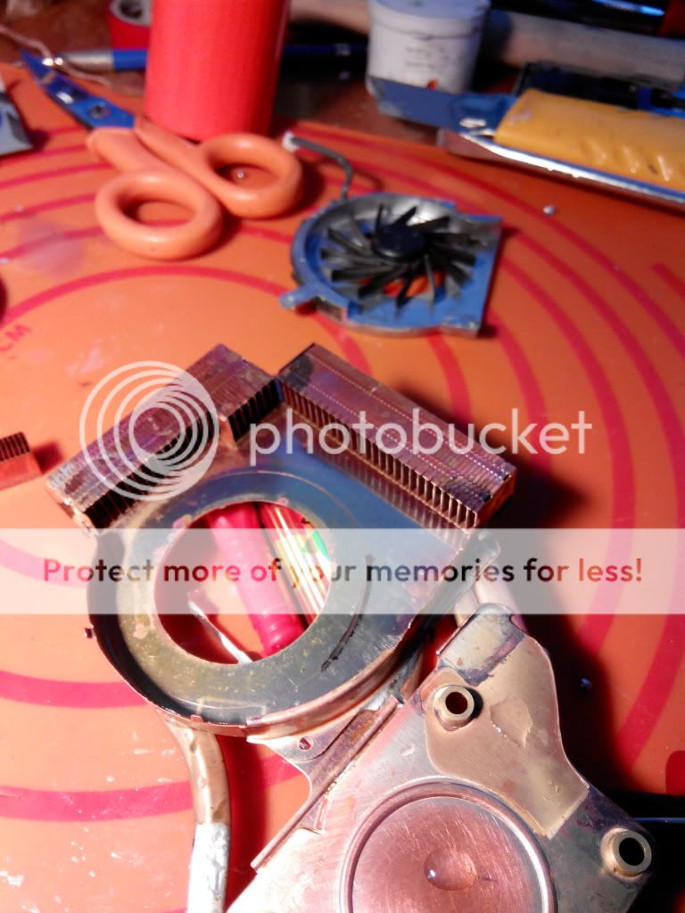

as I said, I already have several drawing element to be added but I think it would slow down the flow and then nothing but harm.
accepted recommendations
stock
http://i943.photobucket.com/albums/ad28 ... ba6e3f.jpg
option1
http://i943.photobucket.com/albums/ad28 ... baed45.jpg
option2
http://i943.photobucket.com/albums/ad28 ... 2d3b90.jpg

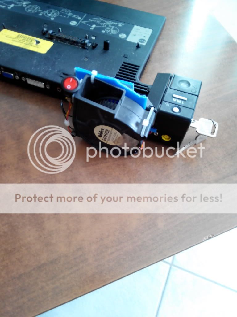

I do not think it's a problem of fans, when I play I keep the fan fixed at 64 with tfc and I also have a fan connected to the docking station , which draws air from the exit , but the temperature of the GPU while playing the game never drops below 70C clearly in heavy overclocking ..
