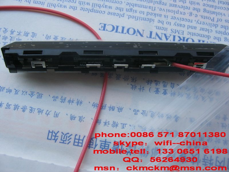

Within each of these antenna kits the individual pieces themselvers have part numbers. As best as I can determine from searches on the internet, the following individual part numbers are :-
91P6989 (possible alternate number is 39T9648)
* 41W5125 MAIN antenna on the LCD lid. The "little ear" or red antenna as appears on Chinese websites.
* 39T9647 AUX antenna under the keyboard bezel. Possibly also listed as 42W2670
* 41W4945 mystery bag.
91P7029 (Vodafone kit)
* ?????? MAIN antenna on the LCD lid. The "little ear" or red antenna as appears on Chinese websites.
* ?????? AUX antenna under the keyboard bezel.
* ?????? mystery bag.
I believe the AUX antenna is identical in both kits but there might be some very subtle changes that escape casual inspection.
Its not uncommon for Lenovo/IBM parts to have 2 or 3 part numbers for exactly the same thing. I want to set up 3 t60Ps up with the right antenna systems for 850-900 MHz and 2100 MHz bands. Some suppliers want $150 -> $200++ per kit. On TaoBao the same thing (if available) is more like $10-20 per kit.
Can anyone help me out with individual part numbers for the Vodafone kit?

First of all - lets see pictures to understand what we are talking about.
1 - old thread with good picture of WWAN kit. Blue antenna is really placed under keyboard bezel (snap to it) and fixed with 1 screw to Mg frame when keyboard bezel is fitted to frame.

Yes, my lid antenna (External bulge) is the one to the left on the picture in the thread you link to. Red cable. So I was after the middle one (Blue cable) but the 91P7029 kit I bought had one antenna with gray cable, and one with a white cable.. I think. And they both seemed to go in the lid. I doubt they are WiFi antennas, as the kit I bought was the Vodafone WWAN kit. But there are apparently different WWAN kits and antennas, probably matched to which frequencies they are meant to receive. So I should probably have swapped my red-cable antenna for the two antennas in the Vodafone kit, instead of just butchering one of them and installing that under the keyboard bezel. But I didn't bother to open the lid one more time.FryPpy wrote:May be your kit have WWAN main (red wired) antenna + 2nd WLAN (WiFi) (white-wired) antennas. Yes all this antennas are go to the lid and if i think right they're exclusive for each other.

thanks for your reply. Yes that photo shows the parts. I have two T60Ps that I got from the USA with those antennas. I have bought the SIM slot cards from Ebay. The machines came with antennas for the EV-DO networks ie kit 91P6989 and have the MC5720 WWAN cards. The cards will be replaced by other WWAN cards to suit 3g on 850/900/2100 MHz bands and 2G on 800/900/1800/1900. I want the antennas to be suited to those bands, but failing that, 800/900/2100 MHz will probably do nicely. So that is Band 5, Band 8 and Band 1. That is two more bands for 3G than you use in Moscow and the additional bands (5 and

http://img04.taobaocdn.com/imgextra/i4/ ... 495652.jpg
The part number is clearly visible as P/N 91P7027.

I got onto it on Monday @ 14:00 Guangzhou time with an email written in English. I found the Alipay account ID for Corsairbbt. If Alipay is like PayPal then the account ID will be their email address. If I dont get a reply soon then I may have to try with DD. I also sent an email to the vendor offering just the red antenna and the patch.If you wanna get antennas from Corsairbbt(媛媛本本), you'd better hurry up cos she listed the antennas for all T60s (standard & wide/14 and 15") together (don't ask me why, it's common on taobao). It's also quite common on taobao to see sold out listings as available. (again, it's also common on taobao).
I am totally relying on online translators. In the translations of Corsairbbt's advertisement, I did not see any widescreen offering although there is a reference to widescreen T60s in the installation notes. I understood from the translation that when placing an order, I needed to specify which kit I was after ie 14.1" or 15" kit. Maybe its cheaper for them to advertise that way.
I appreciate your warnings about dealing with vendors on Taobao. I have dealt with a few Chinese vendors on Ebay with mixed results. Some are quite good and I would not hesitate to deal with them again. I tried dealing with someone on Aliexpress that had the T60 middle frame and frankly the vendor was impossible to deal with and in a few ways just rude. I stopped trying to do business with them. Maybe dealing with an interposing entity that specialises in bridging the western world with Taobao might be the way to go but then again they might only add an extra layer of confusion and source for error.
That suggestion has been made before and it is a good suggestion. I started looking into it already. The limitation is that it has to fit inside the T60P which is not generous with unused space. So, gigantic disk ...hhmmm... maybe not. In many ways trying to get the WWAN fully working in the T60P is tortuous. Just getting the right part numbers with any degree of confidence has been quite a problem but I think it is resolved now. Thanks again for adding weight to it being 91P7027 for the Vodafone red antenna. If I get the right antenna kit then I suspect it wont work well on Band 5 and 8. The suggestion of finding a flexible PCB antenna tuned to those bands makes good sense but that would be need to be connected to the AUX connector. And to get an AUX connector on a card that supports my bands immediately involves the whitelist problem. I understand that only part of the whitelist problem has been removed before by 'Zender'. The ability to use the T60P's RF kill switch with total confidence when I am on a plane is important to me so I think it will be necessary to find ALL of the places in the BIOS which references the WWAN card and remove ALL the whitelisting code. I expect that to be a lot of work. The only alternative that I have is to change the VID:PID of the WWAN card I use to a whitelisted one that does what I want and respects the RF kill switch. Then in Linux, change the driver for the actual card to know how to translate its fake VID:PID. Its a fall back option. Some people might say that I should forget what I am trying to do and just use a pocket wifi hotspot. But I have not given up yet on the T60P being fully self contained for 3G internet.Consider the performance per $, I'd recommend you looking up for some customised antennas on taobao (varies in size and shape from a pen cap to a giantic disk)
Thanks again to all who replied and also 'Troels' who posted in 2008 -- it all helped resolve the 15" T60(P) Vodafone antenna kit part numbers.
P/N: 41W4945 Location
OK - I'm a little late to the party here as only just came across this posting
Sometime last year I stripped out a T60 15.0" with a factory fitted full WWAN kit and came across P/N: 41W4945 which was attached to the right hand hinge (see pix links) - I assume this could be some type of "mini WWAN" antenna to increase signal pick-up diversity(?)
P/N-41W4945(Pix1)
P/N-41W4945(Pix2)
P/N-41W4945(Pix3)
The MAIN (Red cable) antenna P/N was 91P7027 & the AUX (Blue cable) antenna P/N was 39T9647 - I believe that this T60 was at one time connected to the Vodafone network as it had Vodafone sim card in the sim card slot/module and a Vodafone sticker on the base cover.
P/N-41W4945(Pix1)
P/N-41W4945(Pix2)
P/N-41W4945(Pix3)
