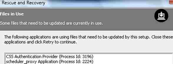

Today I received a new thinkpad T61 with Vista, which I needed to get turned around and out the door quickly. I dutifully ran through the required steps to get the machine configured, then began the update process, recursively going through the windows and lenovo update tools.
Part way through the Lenovo process, I got this wonderful message:
http://www.sequoiahills.com/Linked/Tech ... pidity.jpg
So I go to task manager, but the message doesn't give the .exe names (I should have looked at the 'description' column, but I didn't - my bad). I realize they gave the process ID, so I go back to task manager, turn on process ID display (off by default in vista), and finally determine that this is cssauth.exe and scheduler_proxy.exe. So I killed them, and hit retry ... but scheduler_proxy kept getting restarted by some other process, so I could not get past this. Finally, I hit 'end process' and 'continue' quickly enough to get past it, after about 10 tries.
So here's a piece of software (Rescue and Recovery) that I have no interest in using, and who's update methodology is so poor that they can't update it properly.
This is just one example of the 'baggage' that I'm talking about.
[end rant !]
