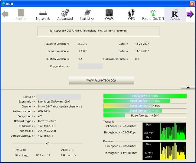

You are right that to utilize 300Mb 11n, I need gigabit ethernet in the house; which I don't have yet. Here is thru put info downloading photos from my NAS thru this 11n Draft 2.0 link.
11n thru put (47KB file)
You can see the 3rd antenna installed in my A31 LCD cover, Signal strength 2, is somewhat weaker than the two standard Thinkpad antennae. My card is 2T3R so ithe 3rd antenna is only used in download.
