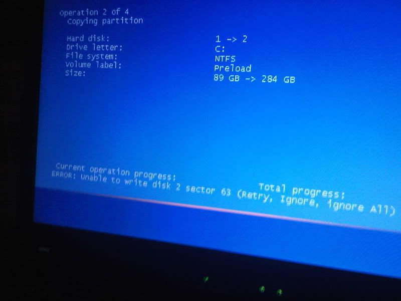

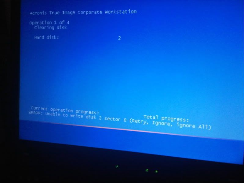

Just tried the Image thing.
And when I went to create the tib file, it kept giving "Sector 0, Fail Read Hard Disk Drive 2" errors and didn't even attempt to write the image tib file to the connected USB back up drive. I also tried a 4GB SD card as a target for the .tib file but I got no success.
Now I'm just going to return and do the clone drive thing all over again which should take about 12 hours. :-(
I'm assuming the original 100GB HD has the errors?
There it is again; more sector 0 errors
img]http://i138.photobucket.com/albums/q250 ... 3-2026.jpg[/img]
img]http://i138.photobucket.com/albums/q250 ... 3-2027.jpg[/img]

Delmarco wrote:I'm assuming the original 100GB HD has the errors?
If you do a Start --> All Programs --> Accessories --> Command Prompt --> chkdsk c:
.... then it will run the chkdsk in "read only" mode and will tell you if there are bad sectors or other NTFS file structure errors.
If there are errors, then you will need to cause an "error-checking" process to run upon re-boot which will attempt to fix all of the file structure errors on the disk and recover any data off of "bad sectors".
Re: Much Slower Start Up After 100GB to 320GB HD Upgrade?!
Posted: Wed May 13, 2009 7:40 pm
by mgo
Delmarco wrote:Just tried the Image thing.
Have you tried running CHKDSK on both drives...especially the original 100 gig you are trying to image?

The "write errors to disk 2" bother me.
Since the 320GB drive should have nothing on it when the cloning process starts, then I would re-format it to make sure that it has no problems.

I finally got it.
1. I ran the disk check error on the original 100GB drive making sure all errors were fixed. I also defragmented the 100GB drive.
2. Then I did a full format of the new 320GB (whereas before I was doing quick formats)
3. Finally I ran Acronis Disc Clone.
It was not only quicker this time about 1 hour instead of 10 hours, but the were NO error messages at all.
Now I got the 320GB drive installed and my T60 boots up quick and clean like the day I bought her home and took her out the box.
Thanks everyone. I really appreciate your help.
