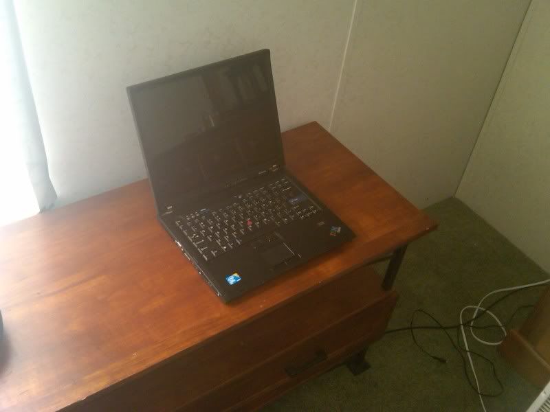

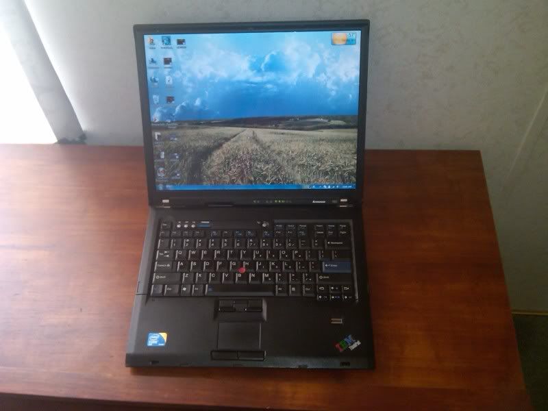

Ok just put the screen in and I will take some pictures tommorow !!! but This screen is amazing!! I feel like i just bought a new computer !! all of the colors are bright and crisp and the blacks are actually black.
Love it !!
Love it !!

The only negative it my computer lost almost 25 mins battery life due to the new screen upgrade but in return I got a really nice bright and crisp screen!!

Also I bought the screen for $100 but immediately after I bought it the seller changed the price to $200
- Posts: 17513
Re: Need some help on deciding what screen to replace my laptop
Thanks, that's an LG Philips screen, not a glossy one as you describe, but a standard matte one.
Here's a data sheet:
http://www.gblcd.com/datacenter/lg_Phil ... 7-TL02.pdf
The only difference between TL02 and TL03 is most likely just the coating difference. It's a TN panel, but with a minimum allowed contrast ratio of 350:1. Not bad
fry112
- Posts: 78
- Joined: Sun Aug 16, 2009 4:26 pm
- Location: Charleston, West Virginia
Glossy Matte??! Almost identical don't be an [censored]!
I only said glossy because that was the what the seller was stating , Although the Matte looks better than the glossy screen on my sony so I guess I got the better screen.
emeraldgirl08
- Posts: 1759
I like the screen Fry
and your laptop! Looks very nice
