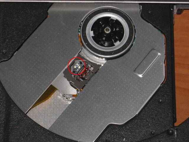

- Posts: 10053
Re: Matshita Drive won't recognize many regular CD's in my T60
If you have already decided that the drive is useless, then you can attempt cleaning the lens. A cotton swab dipped in isopropyl alcohol and gently rubbed over the lens might be enough to save the drive.backdoorman wrote:What can I do except buying a new drive?
http://www.kawakami-ca.com/images/laser_assembly.jpg
