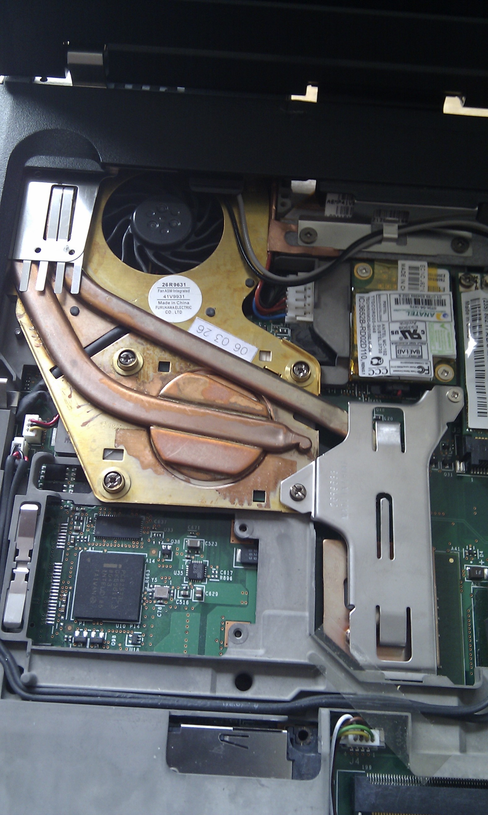

I took it apart and i think the problem is in the fan assembly.
I think this, because even with the T1300 processor in the T60, the temperature is 65 degrees Celsius directly after boot.
The current fan has these numbers:
26R9631
41V9931
Picture of the current fan assembly: http://tweakers.net/ext/f/LQ7W4s92IEIDM ... W/full.jpg
I have tried bending the piece of the fan that is on top of the CPU, but it doesn't help. When i touch the copper part above the CPU it is quite hot (can't touch it for more than 15 seconds), so the CPU is transferring the heat to the fan assembly, but if i follow the heatpipe with my finger it is only mildly warm in the upper left corner.
Can anybody advice me which replacement fan i should get?
26R9631
41V9931

Your board should (have) come with a 41V9931 fan.
The previous bending (by you or a previous owner) might have cracked the heatpipe(s) and let the coolant out.
A new unit should do the trick.

I found this post:
http://forum.thinkpads.com/viewtopic.ph ... 80#p609980
This is interesting:
Can i just pop in an 41W6406 fan, or is there difference between fans regarding screen size?
The current fan in my T60 is the first one, but my T5500 is an Core 2 Duo, so i think i need the second one (41W6406). I looked up a picture of the 41W6406 and it has a double heatpipe on the CPU part, where my 41V9931 only has 1 heatpipe on that areaAlso, it seems like there's 4 different fan types:
41V9931 (for Intel graphics and Core Duo cpu)
41W6406 (for Intel graphics and Core 2 Duo cpu)
41V9932 (for ATI graphics and Core Duo cpu)
41W0467 (for ATI graphics and Core 2 Duo cpu)
Lenovo ThinkPad T410

UPDATE:
Received an 41V9932, wiped the cooler + CPU clean, and put on some fresh silver cool paste. Popped in the fan, assembled the laptop.
Result: 62 degrees idle, 72 degrees (Celsius
) with some programs (Chrome with 7 tabs, MSN, Outlook, Spotify)
I think something is wrong with my T60, but i can't figure out WHAT
However, it is a little upgrade, with the old cooler (41V9931) it was like 75 degrees idle, and would kick 88 degrees without much effort
Are there any parts (cooling clamp on underside of the mainboard for example) that can cause bad performance of the cooler? Or maybe a support frame or something like that?

Re: CPU heat issues after upgrading T1300 to T5500. Which fan?
Maybe you got the T5500-DeLuxe model with built-in central heating?
Could well be you have a bad CPU.
Beg/steal/borrow a T7200 for comparison.
