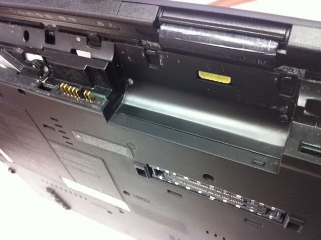

Thanks for the replies. I took the keyboard off and it looks it's just kind of a poor design. In the shell there's a section of the rollcage, on top of which the ribbon cable sits. I guess where the keyboard meets the rollcage there, it's just too thick of plastic and it bends up a tad. The wifi antennae look like they're routed properly, too. The keyboard bezel (the piece that contains the speaker covers) DOES bow up as well, but not as much as the section of the keyboard that contains the power/volume/blue buttons.
Here's a picture of it.
Note: it's not quite as severe as this picture makes it look; I was trying to emphasis it a bit with the camera angle to make the flaw more visible.

Posted: Wed Feb 16, 2011 2:57 pm
by Harryc
That is not right. I agree with what Richk said to do. The keyboad bezel is not installed correctly. Someone missed a tab. Be gentle, those tabs snap off easily.

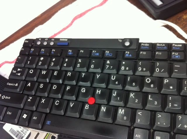

by Stadsport

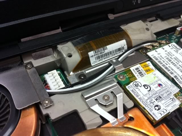

Just took it apart again. Again the antennae didn't look like they were interfering but I re-routed them slightly the more closely match the diagram in the manual, it didn't seem to make a difference.
This was before I removed the keyboard bezel and rerouted the antenna cables, so they didn't "dip down" over the side of the little guide tray.
Doesn't seem to be a problem with the keyboard itself.
All the little clippies are right where they should be

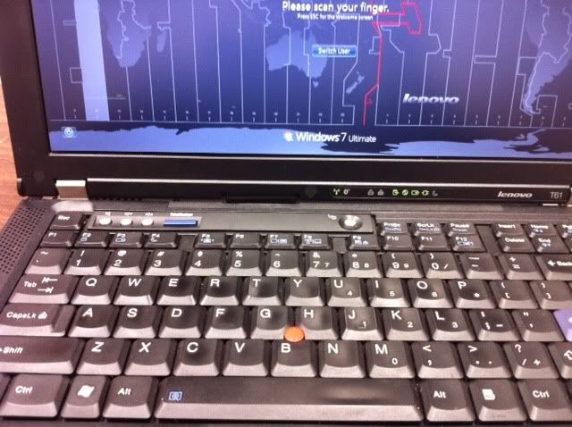

And here it is back together, not really any better than before. I almost wonder if there's something under the ribbon cable? Make I should take it apart a third time...
Update: I did end up taking it apart again. I peeled up the tape holding the ribbon cable down and kind of reseated that. There are two little guide notches that align the ribbon cable, and on the reverse side there's a green stopper that pokes through a slot you can see with the battery removed. This keeps the ribbon cable planted on the body side of things, so it can slide in and out of the lid as you adjust the screen. It looks like the ribbon cable was just slightly mis-aligned, causing that stopper to hang up on part of the case and push everything up just a mm or so. Despite the plastic pieces themselves being slightly bowed from being in this state for an extended period of time (I just got the laptop, but it's just under 3 years old so who knows when it was done), the bowing does seem reduced now.

by richk
Your update was what I would suggest from the picture. THe "lump" on the bottom of the cable looks too far forward in the picture. You might need to replace the clear tape. It is stronger than scotch tape, but scotch tape will work if you get it nice and flat. It is tricky to hold the cable in place and get the 2 pieces of tape on smoothly

by Stadsport
I didn't have much trouble getting it to re-stick; I was really careful not to get it dirty/oily or anything when I pulled it up, but if I continue having issues with it then I'll replace the tape. So far it seems to be more or less solved. Thanks.
