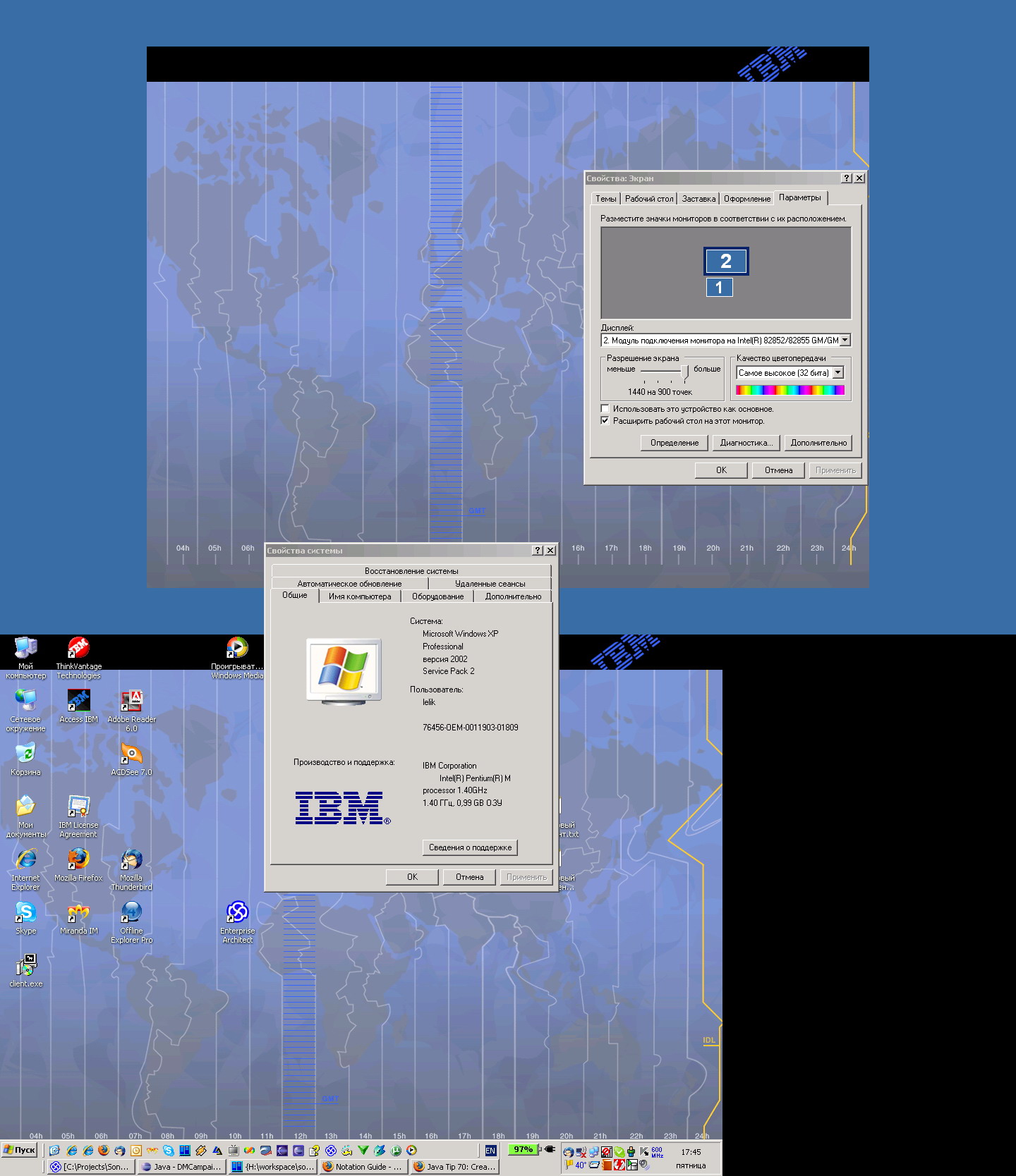

Hmmmm... Are all of you sure that some tricks should take place to turn external wide screen on? Bet that you're wrong!
First, look at the screen shot I've made on my working environment - X40 with laptop LCD@1024*768 plus external wide screen LCD@1400*900 (ViewSonic VA1912w):
http://lh6.google.com/image/aleksey.fed ... pg?imgdl=1

Just to confirm that the instructions posted by Nokia Adept work perfectly for me
My set up is an X40 and a brand new Videoseven 22in widescreen (1680 X 1050).. works like a dream.
Reading other posts on this and other forums there seems to be a lot of confusion about X series and widescreen. It looks to me that by following the below instructions the VBIOS is not consulted and the monitors own display table is accessible. I would guess this will only work on fully plug and play compliant monitors.
Thanks BNA for posting this... enjoy your widescreens.
