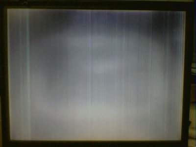

My usual T23 looks like this every now and then:
http://www.kawakami-ca.com/images/t23_white_screen.jpg
I attribute this problem to a loose LCD cable, either where it's plugged into the motherboard or at the back of the LCD panel or it's got a crack in it somewhere. In fact, before I took this lousy picture with my Palm Zire 71, the screen was working fine. I simply moved the panel around and twisted it slightly until it went all white. At other times there's lines across the screen or the image "rolls" like a television with a bad vertical sync problem.
If your problem seems to be related to the temperature, then I'd think that it's a video chip issue on the motherboard.
edit: As to the "crash", unless you plug in an external monitor and can see what's happening, your operating system may be working normally. In fact, the next time your screen goes out, if you can, attach a monitor to the VGA port, press the Fn+F7 key combination and see if you get a display.
